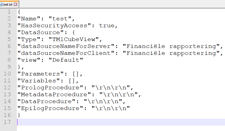

Next, the text file contents of 'D:\test.txt':
"Name": "test",
"HasSecurityAccess": true,
"DataSource": {
"Type": "TM1CubeView",
"dataSourceNameForServer": "Financiële rapportering",
"dataSourceNameForClient": "Financiële rapportering",
"view": "Default"
"Parameters": [],
"Variables": [],
"PrologProcedure": "\r\n\r\n",
"MetadataProcedure": "\r\n\r\n",
"DataProcedure": "\r\n\r\n",
"EpilogProcedure": "\r\n\r\n"
Executing this in Postman works absolutely fine. Lastly, the PowerShell file:

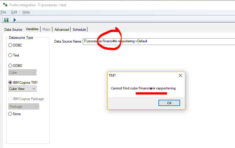

If I execute the PowerShell file manually or through TI, it takes about 5 seconds. And still the datasource is not 'Financiële rapportering' but rather 'FinanciWRONG_CHARACTERle rapportering'

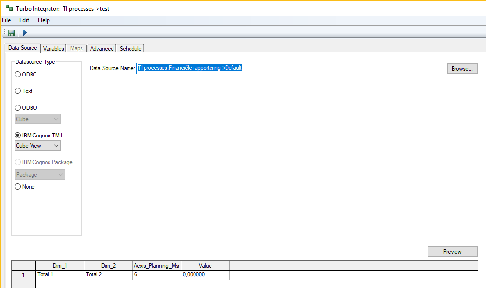

Re: Create a process with TM1 REST API where data source contains accented characters
EDIT: gotcha, it's UTF-8, my bad. Now it works fine !

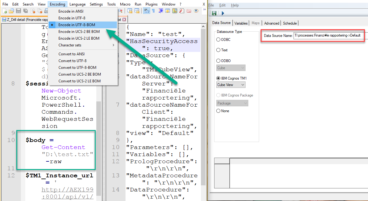

I have done that, no luck yet.
On the left, the PowerShell call of with the test.txt file on the right (with encoding now changed).
Then the TI process with missing accent character.

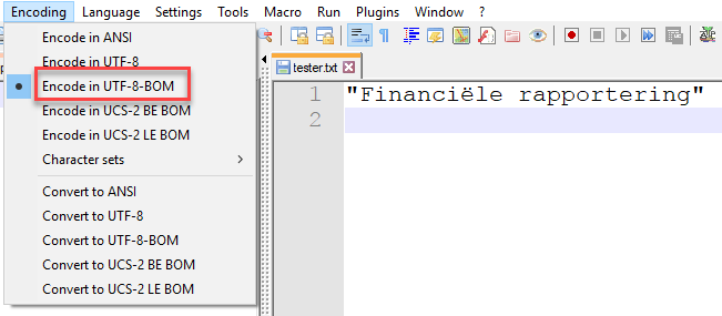

Still having an issue with the character set.
This small TI process:
sFileName = 'tester.txt';
SetOutputCharacterSet( sFileName, 'TM1CS_UTF8' );
TextOutput( sFileName, 'Financiële rapportering' );
gives me:

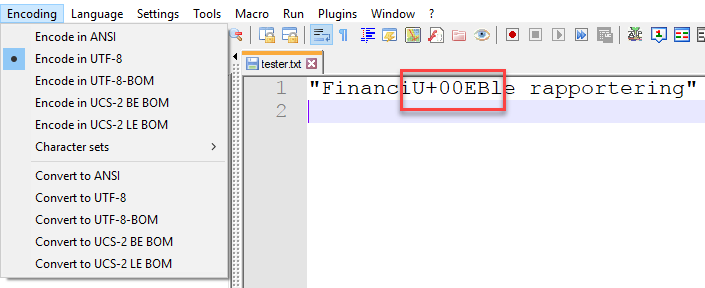

While changing the character set to the below gives me:
SetOutputCharacterSet( sFileName, 'TM1CS_UTF16ESC' );
gives me:
Source for character sets:
https://www.ibm.com/support/knowledgece ... aracterset
What should I use to see the right character WITH the right encoding set of UTF-8 in Notepad++ ?
