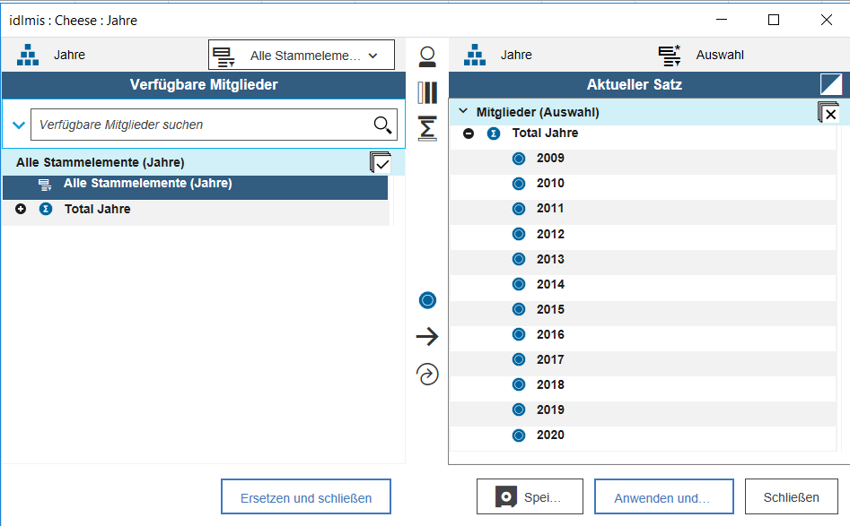

We want to use PAX including the set editor (example what I mean in attachement (don't know the exact english name)).
But we won't allow the user to log into PAW. Is it possible to block the PAW login without block PAX? If yes, how?
