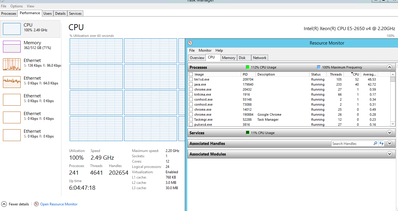

1) I want o understand how CPU utilization works in resource monitor (through task manager). We have 24 logical processor and CPU activity shows more then that. Please review following image for it. We on windows 12.
CPU Utilization Reading.PNG (136.56 KiB) Viewed 11374 times
