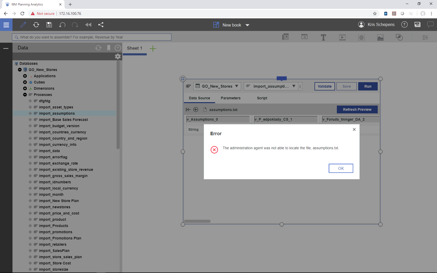

I have an issue in the PAW TI editor. Maybe others have had this too.
In an IBM model for TM1, there are TI processes with a Text file as the Data source.
If I drag and drop the process name on the canvas, an error message comes up that the source file cannot be found:

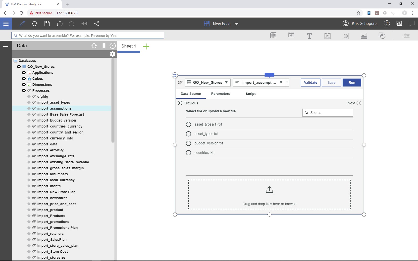

When the data source (text file) is set AGAIN, it seems to work and PAW remembers the locations of the most recent files.
However, I am not interested in recreating the data sources again for existing TI processes.
This being said, once the data source is fine, where in the TI process in the editor can I see the full path ?
I mean, opening up a process later on and wanting to check the full file path, where can I have that information ? I can only find the filename without the path.
