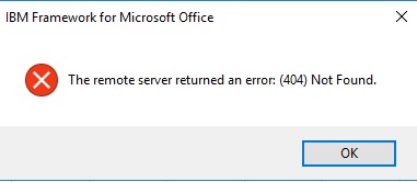

bResult = CognosOfficeAutomationObject.Logon("http://10.5.194.90", "Admin", "Password", "AD")
bResult is False and also I receive error
3. After it I repeat step 1
bResult = CognosOfficeAutomationObject.Logon("http://10.5.194.90", "Admin", "Password", "AD/SData")
bResult is True
Also I can write
bResult = CognosOfficeAutomationObject.Logon("http://10.5.194.90", "Admin", "Password", "SData")
I receive error after 1 step
but bResult is True
That I should write to connect in one line and without errors I don't know

bResult = CognosOfficeAutomationObject.Logon("http://host", "Admin", "Password", "AD") worked how you can connect to the Tm1 server?
Actually I cant able to give the Tm1 instance, but its connecting to tm1 server instance. I have only one instance running in mode 5. Even I am wondering how its connecting to tm1 instance without giving tm1 instance name.
I raised the same question to IBM and waiting for reply.
