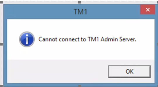

I am unable to connect to TM1 server from perspectives as a non-admin user. It is showing error as cannot connect to Tm1 admin server.
i was able to connect to TM1 server when i logged in as admin user.
can i know what is causing this issue.
Cannot connect to TM1 Admin server from perspectives

Hello All,
The issue is observed when we try to connect from TM1 excel add-in for all admin and non-admin users.
- Posts: 6672
Re: Cannot connect to TM1 Admin server from perspectives
The admin server has nothing at all to do with whether a person is an admin user or not. The admin server doesn't know or care whether the user even HAS a login. Its sole and exclusive role is not to connect you to the TM1 server, but to provide you with a LIST of TM1 servers that are running and registered with it. You then select one or more of the servers from that list to connect to.
If you can't connect to the Admin Server then usually the Admin Host has not been set correctly in Perspective's options. It needs to be:
(a) The name or IP address of the machine that the admin server is running on; and
(b) The client needs to able to connect to that server inside the network.
You can usually test the second of these by opening a command window (ON THE CLIENT MACHINE, NOT THE SERVER) and using the Ping command to see whether you can get a response using the machine name that you have entered as the Admin Host. If you can't. try using the IP address of the Admin Host instead. If that doesn't work either, then you have a problem with the Admin Host being correctly connected to your network and/or configured, and it's time to have a word to your IT department.
Hi Alan,
Thanks for the Help!
Somehow Admin host details was missing in perspectives. Went to options and added admin host details and was able to connect to TM1 server.

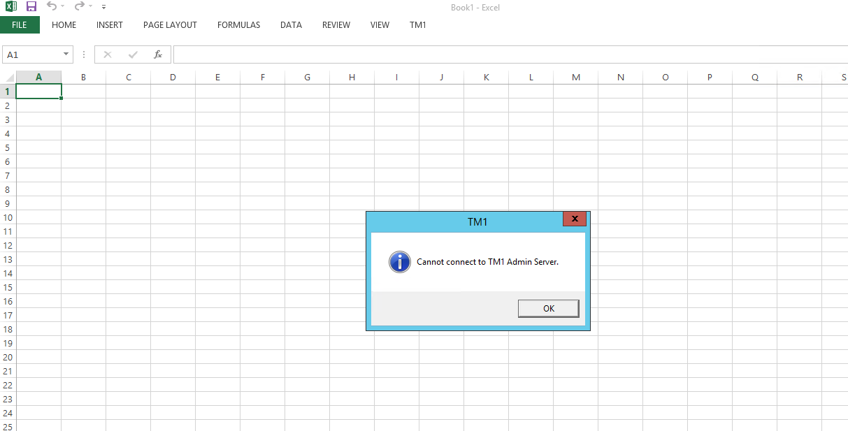

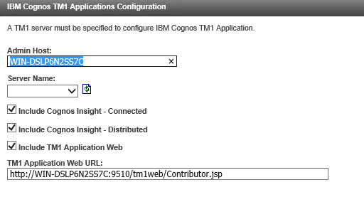

hi
Please, I needed help with operating a TM1 server
I have taken all necessary steps to run the server, but there is no connection between them
This picture shows what I have done and also shows the problem
Please help me because it is very important to me

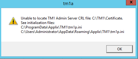

- Perspectives.PNG (19.02 KiB) Viewed 6178 times
- excel.PNG (33.41 KiB) Viewed 6178 times
- architect2.PNG (8.4 KiB) Viewed 6178 times
