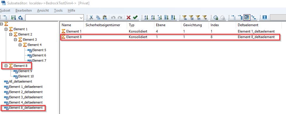

I wrote a rule to set an indicator for changed values in spite of distributing those along their children (a handmade spreading function, finally).
I use the concept to have a N-element outside of the main hierarchy for each C-element I want to be able to be a starting point of this spreading.

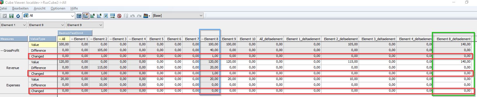

The dimension ValueType makes up 3 layers (value: the working layer, change: layer to set flags in spite of deriving a view as small as possible to perform the spreads later, difference: points out the amounts to spread on a flagged C-element to support the spreading later).
For example the Element 8 got a new target value (Element 8_deltaelement to take the value ad interim, bound to its original C-element via an attribute 'deltaelement'): 140/green instead of 120/blue = Changed:1 => Difference=20

My question about that: Did I oversee a more generic way to achieve adressing the C-elements which are actually named in the area definitions between the curly brackets? Here I have only 6 C-elements, but I doubt how this solution could carry even a system having hundreds of c-elements in a real world application. Is this best practice?
Is it a good style to keep the feeder statements such generic, or should I better narrow them also by a subset expansion?
