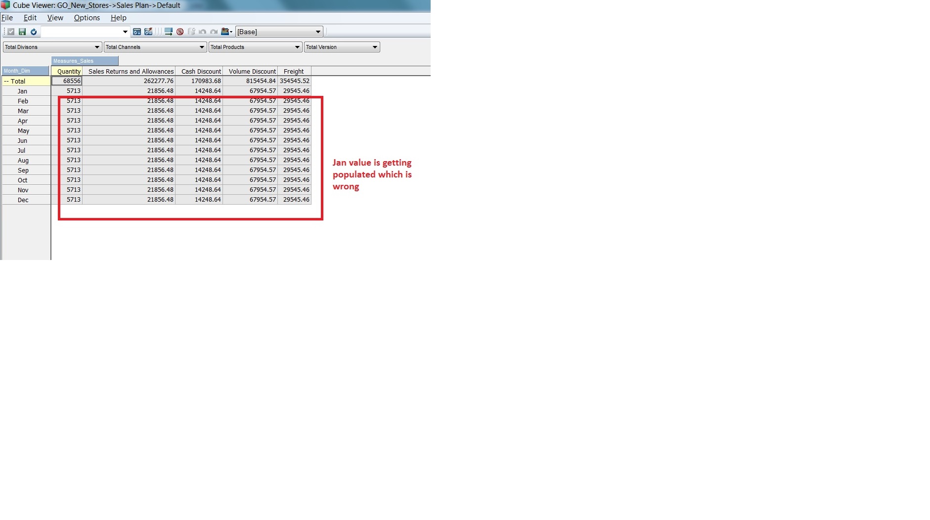

The same value for the January month is getting populated for the other periods also when ran with the parameter 'All'. Can anybody tell where I am going wrong with the While loop. I tried to do the Asciioutput also but couldn't figure out the issue.

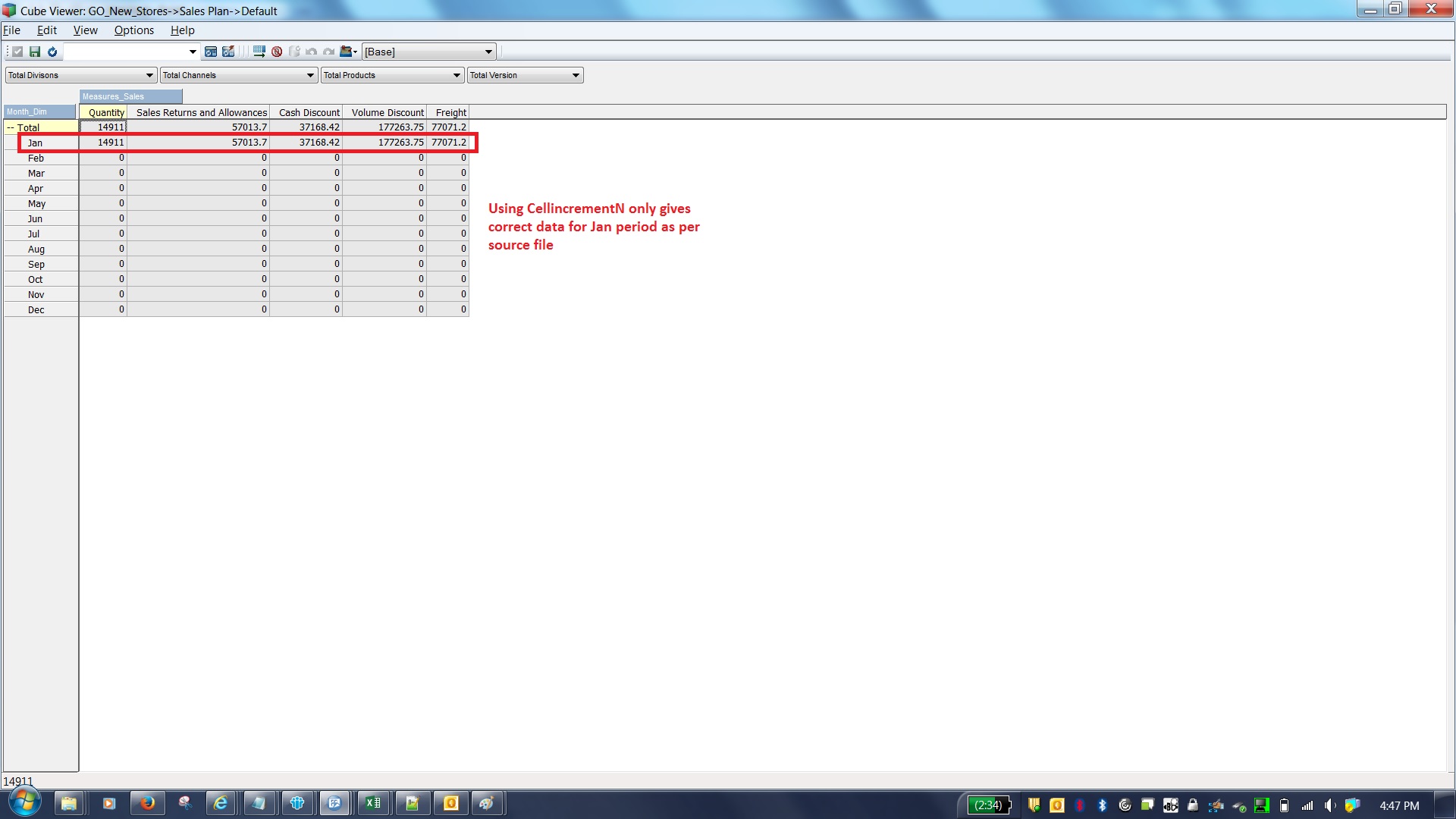

Actually when I run the TI process for parameter value = Jan, it should sum up for the Jan period, and when ran for Feb month it should sum up for Feb period as per the Source. And apart from this when I run for the parameter 'All', the data should be populated for all periods doing the same approach when ran for single period. The issues I have are
1. When ran for the single parameter value e.g. Jan, the value is not summing until I use Cellincrementn. I don't understand why there is need to use cellincrementn if I am using the same file, instead of cellputn. E.g. Need for Jan (1969+398) for budget version1.
2. When ran for the parameter value= 'All', it should populate the values as per the source file. But for me the january data is only getting populated or the other period also which is not expected.
Attached are the screenshots.
Thanks in advance!!

I have now modified the code, removed the while loop and data gets populated correctly by using cellincrementN only but cant I use CellputN to sumup the values to achieve the same result?
if(V6@=pPeriod % pPeriod@= 'All');
cellincrementN(Quantity,'Sales Plan',pDivisons,Channels,Products,Versions,V6,'Quantity');
cellincrementN(SalesReturnsandAllowances,'Sales Plan',pDivisons,Channels,Products,Versions,V6,'Sales Returns and Allowances');
cellincrementN(vCashdiscount,'Sales Plan',pDivisons,Channels,Products,Versions,V6,'Cash Discount');
cellincrementN(vVolumediscount,'Sales Plan',pDivisons,Channels,Products,Versions,V6,'Volume Discount');
cellincrementN(vFreight,'Sales Plan',pDivisons,Channels,Products,Versions,V6,'Freight');
endif;
Thanks in advance!
endif;
Thanks in advance!

It should be noted that your process wasn't copying January values to every month but was copying the values in rows 5, 7 and 10 (so quantity for these rows is 5713). Why these rows? Because this is where your rows (For columns b:d) were unique.
