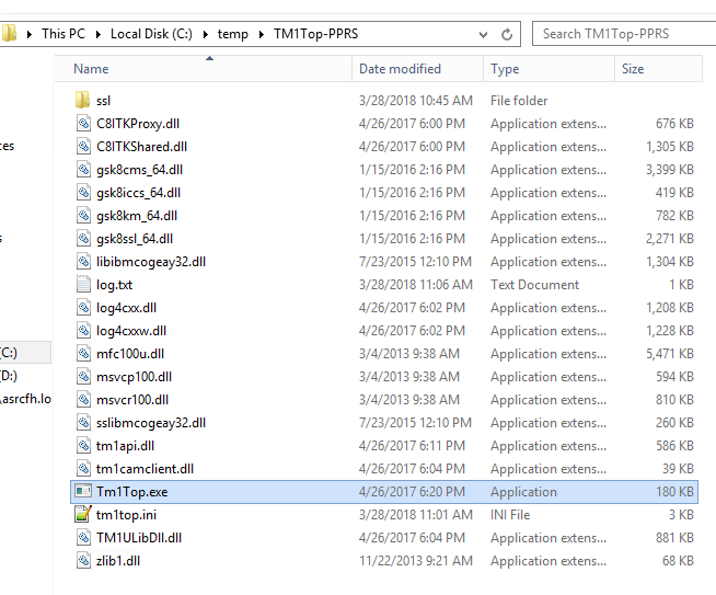

I have just stood up a new instance of PA2.0 and TM1top is not working. I have gathered the files like in 10.2.2 into a folder and it gives an error.
Could not connect to server "sdata" on admin host "--ADMIN_HOST--"
Press "R" to retry, any other key to exit
I have attached a pic that the list of files in the folder. Are there any extra files that have to be added to the folder? Can someone help?
Also, when I change the default tm1top.ini file, it says "Please check if this file is opened in another program".

You missed some files and directories for PA2.
1. C directory
2. gsk8valn_64.dll
3. gsk8dbfl_64.dll
4. gsk8kicc_64.dll
If you get the copy from installation folder, it should run fine.

Figured it out. Here is a full list.
C
N
ssl
gsk8acmeidup_64.dll
gsk8cms_64.dll
gsk8dbfl_64.dll
gsk8drld_64.dll
gsk8iccs_64.dll
gsk8kicc_64.dll
gsk8km_64.dll
gsk8ldap_64.dll
gsk8msca_64.dll
gsk8mscng_64.dll
gsk8p11d_64.dll
gsk8p11_64.dll
gsk8ssl_64.dll
gsk8sys_64.dll
gsk8valn_64.dll
log4cxx.dll
log4cxxw.dll
msvcp100.dll
msvcr100.dll
tm1api.dll
tm1top.exe
tm1top.ini
TM1ULibDll.dll
zlib1.dll
