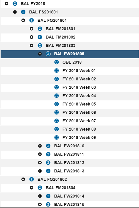

  • Create an alt hierarchy in the Weeks dimension called "FY_Balances" which contains BAL consolidations and an opening balance element for each year (see screenshot).

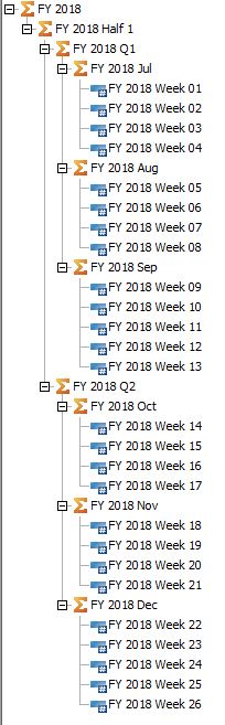

Here's the Primary hiearchy:
Here's the "FY_Balances" alt hierarchy:
(Note: the consolidated elements have all but the last child with zero weight to make sure the balance shows at every intersection)

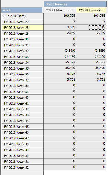

And here's what I'm seeing in the cube viewer:
As you can see, it's simply replicating the movement value, not fetching the balance from the alt hierarchy. When I trace the rule, I get an unfamiliar notation for the alt hierarchy. In the element list the following string appears:
