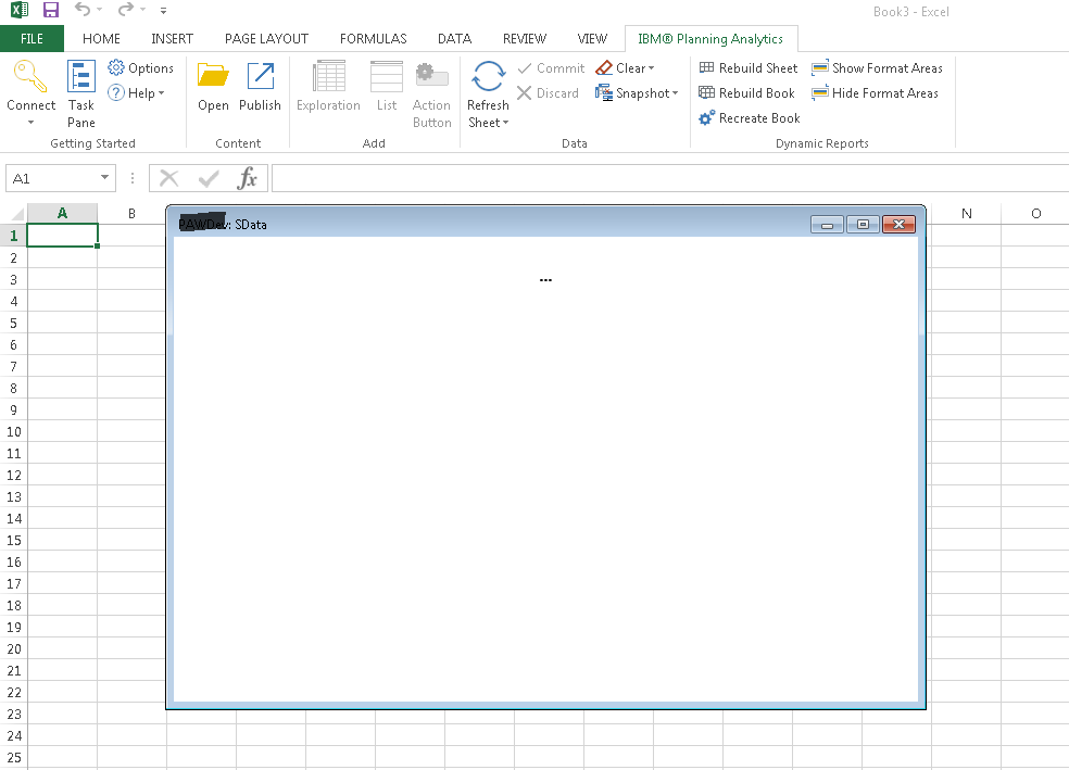

I have installed, configured and tested all CA and PA stuff on win server 2016. Everything is working fine (CAM and single sign on ) except for PAx. I configured and tested the PAW server successfully which is saying server online from one PC client with Office 2013 32-bit. But when I click on TM1 server from Connect menu, the login page is blank and hanging with three dots. Any idea? I followed the guide from the link https://www.ibm.com/support/knowledgece ... rview.html

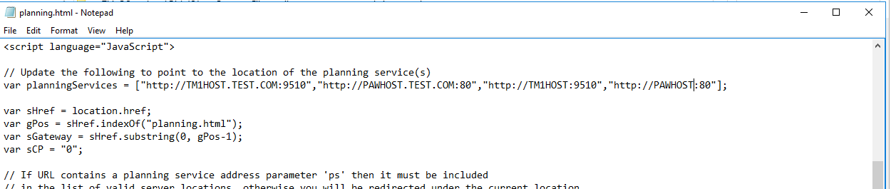

Are you sure you have added the correct addresses to the pmhub.html and planning.html files? If you right click on that window and click properties you will see the broken link that it's trying to open. You're likely missing one of the necessary server/port addresses within one of these files. The variables they could possibly be missing in are located in your webcontent folder
var planningServices in the planning.html file (Make sure has all TM1 application servers and your gateway) or
var pmhubURSLs in the pmhub.html file (make sure this variable includes your paw, gateway, and application servers).

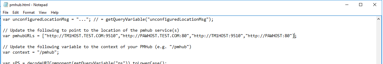

Here are my configurations.
TM1HOST is where I have TM1 server up and running.
PAWHOST is where I have PAW server up and running.
Both are fine and works as expected.
Thanks for prompt response.
- planning.png (18.79 KiB) Viewed 20056 times
- pmhub.png (16.29 KiB) Viewed 20056 times

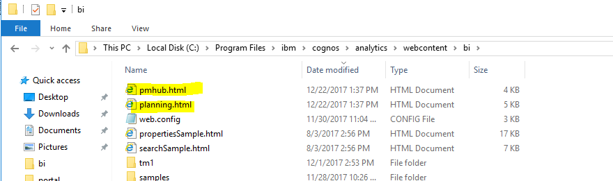

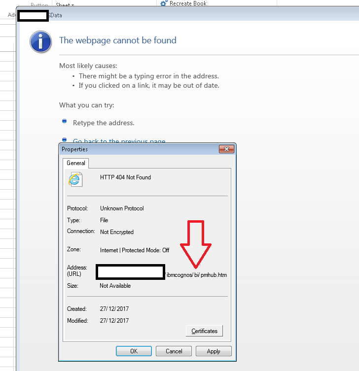

BTW, I have same copies of those two files under bi folder as well. Because I don't do this, the login page can't be found as PAx is trying to use everything under bi folder.
- not found.PNG (35.54 KiB) Viewed 20055 times

If you right click and view the properties on the window with '...' what is the web address that it is trying to access? There could also be a problem with your IIS settings for SSO causing the issue. There is a possibility that IIS is looking for a file that is not currently located in the correct file location. We found that the pmhub.html files and planning.html files needed to be located in both the install/webcontent and install/webcontent/bi folders based on the instructions for SSO that IBM provides.

Hi, here is the link behind three dots.
Here, TM1HOST and Cognos Analytics HOST are same VM server. I installed them on the same server.
http://TM1HOST.TEST.COM/ibmcognos/bi/pmhub.html?cam_passport=MTsxMDE6NmM4YzQ4ZWItZDA2OS0zM2QyLTg4NTctZmVjODg5ZTQxNDAwOjM0OTk4NDY3NTg7MDszOzA7&CRN=linesPerPage%3D15%26columnsPerPage%3D3%26skin%3Dcorporate%26showHiddenObjects%3Dfalse%26backgroundSessionLogging%3D1970-01-01%2B00%253A00%253A00%26productLocale%3Den%26timeZoneID%3DAustralia%252FBrisbane%26format%3DHTML%26showWelcomePage%3Dtrue%26listViewSeparator%3Dnone%26showHints%3DshowAll%26displayMode%3Dlist%26http%3A%2F%2Fdeveloper.cognos.com%2Fceba%2Fconstants%2FbiDirectionalOptionEnum%23biDirectionalFeaturesEnabled%3Dfalse%26contentLocale%3Den-au%26http%3A%2F%2Fdeveloper.cognos.com%2Fceba%2Fconstants%2FsystemOptionEnum%23accessibilityFeatures%3Dfalse%26automaticPageRefresh%3D30%26showOptionSummary%3Dtrue%26&ps=http%3a%2f%2fPAWHOST&pg=%2fpmhub%2fpm%2ftm1%2fapi%2fSData%2fv1%252e1&vers=10.3&unconfiguredLocationMsg=The%20PMHub%20service%20parameter%20was%20not%20specified%20or%20is%20not%20one%20of%20the%20configured%20locations.Yes, this is what I did. Copy those same two files for install/webcontent and install/webcontent/bi.We found that the pmhub.html files and planning.html files needed to be located in both the install/webcontent and install/webcontent/bi folders based on the instructions for SSO that IBM provides.

Appreciated your help, mate! After testing around several times, I finally made it!!!codingCPA wrote: ↑Wed Dec 27, 2017 4:29 pm The sso portion of the login is working. The problem is that once it is, it is not finding your paw server resources. Do me a favor and try one thing. I was just able to reproduce this on my dev server again. Add your PAW host WITHOUT a port in your pmhub.html file. Also, if you are going to navigate to workspace in your browser what address do you go to?
The things I have learnt are:
1. No need to change anything in pmhub.html and planning.html under webcontent. Just keep original 9510 URLs there.
2. Copy pmhub.html only to webcontent/bi folder and append "PAWHOST" and "PAWHOST.TEST.COM" without port number in pmhubURLs
3. No need to reboot Cognos service, this change will take effect immediately after saving pmhub.html
4. From PAx, if you add "PAWHOST" only to pmhub.html, then you MUST use "http://PAWHOST" in the connection URL to connect TM1 server although testing connection will be passed if you put "http://PAWHOST.TEST.COM" in the connection URL. If you add "PAWHOST.TEST.COM" only to pmhub.html, then you MUST use "http://PAWHOST.TEST.COM" in the connection URL. If you add both, then you can use either of them in PAx. So in my case, I add them all.
Happy to answer any question for PAX, PAW, PAL and CA for win 2016 configuration!
