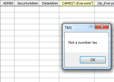

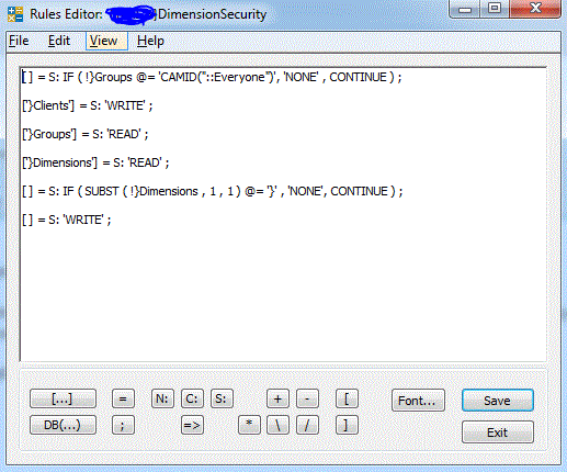

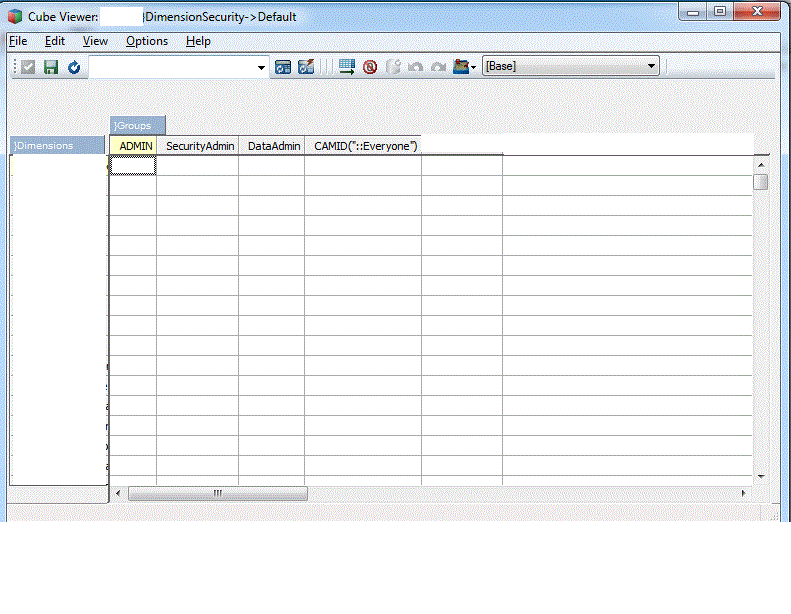

I need to secure Dimensions so I have written rules for }DimensionSecurity cube, but for some strange reason, the Ruled cells are not being populated. There is no feeder or anything, and If I try to key-in some text in the Ruled Cells, TM1 throws an error saying "Not a number value"
Attached is a screenshot with the Rules ( I have simplified the Rules just for testing purposes )
This happens randomly, usually after I make changes to other Security Cube Rules and click of SecurityRefresh, but I cant reproduce it all the time
I have similar rules for }CubeSecurity and }ProcessSecurity, but I have not seen this issue in those cubes?
Any Idea?

That's some of the weirdest looking syntax for a rule on the }DimensionSecurity cube I've seen.
Do you really have groups called }Clients, }Groups, and }Dimensions?????? That's what part of your rule is doing, it's assigning rights to those three specific groups.
['{Clients'] = S:'WRITE';
['{Groups'] = S:'READ';
['{Dimensions'] = S:'READ';
Re: DimensionSecurity Rules not being fired
Euh Tom, the OP assigns (the same) rights to all groups on the dimensions that are mentioned. They are not group names but dimension names. Also it’s } instead of {
Which is not to say that I agree with these rules or the way of working.

Hi Tom,tomok wrote: ↑Wed Nov 01, 2017 10:42 pm That's some of the weirdest looking syntax for a rule on the }DimensionSecurity cube I've seen.
Do you really have groups called }Clients, }Groups, and }Dimensions?????? That's what part of your rule is doing, it's assigning rights to those three specific groups.Code: Select all
['{Clients'] = S:'WRITE'; ['{Groups'] = S:'READ'; ['{Dimensions'] = S:'READ';
Those are Dimension Names, so I just wanted to illustrate with en example what I am experiencing. These dimensions exist in each model that's why I used those, but the rule that does not get fired is the rules that apply to the whole cube ( see the lines below )
[ ] = S: IF ( SUBST ( !}Dimensions , 1 , 1 ) @= '}' , 'NONE', CONTINUE ) ;
[ ] = S: 'WRITE' ;

Actually I tried deleting the }DimensionSecurity and after that, non-admin users cannot see any dimensions and therefore they cannot open any of the CubeViewslotsaram wrote: ↑Thu Nov 02, 2017 3:25 pmThe issue you are describing does sound like a bug.tm123 wrote: ↑Thu Nov 02, 2017 1:44 pm The problem is that if I delete the Rules and also I delete the }DimensionSecurity cube from my model, then non-admin users cannot open any of the cube views, so I need to populate the }DimensionSecurity somehow. I know I can write a TI process to populate that cube, but I don't understand why the Rule is not working
But why do you need dimension security at all? If the }DimensionSecurity cube is deleted then the default security level for ALL dimensions is READ. The only reason you would ever need to apply dimension security would be to hide a dimension from some user altogether because the element names themselves are confidential in some way. Not very many models have this requirement and so have no need for dimension security.
after deleting the }DimensionSecurity, if I go to Dimension Security Assignment grid, the default access for all Cognos BI Groups is "NONE"
