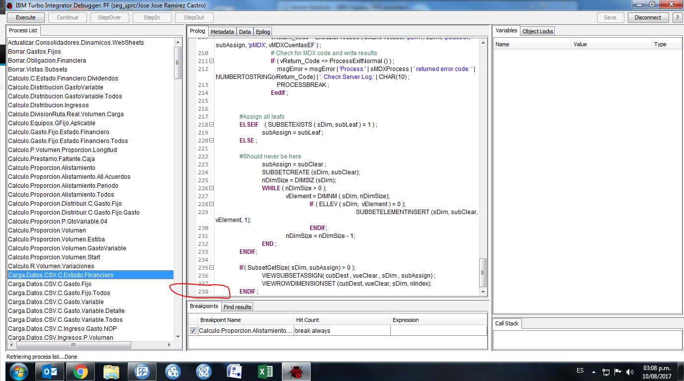

Hi!
After install the Fix pack 7 (FP7) i also installed the Tm1 Turbo Debugger Tool as said it in https://developer.ibm.com/recipes/tutor ... -debugger/
Now I can add break points when executing TI Processes and it works ok, but the problem is I can not visualize all the code lines in the prolog, Data or Epilog. it is always incomplete. For example:
It only shows me until line 238 but the prolog has 22 lines more. (it happens with every process with different number of lines)
maybe something is missing in configuration file? or did i make a mistake in installation process?
I am pretty new using TI Process and TurboDebugger so many thanks in advanced.

The debugger is fantastic, however I am have the same problem with the missing lines of code. It does not consistently occur, ie it does not depend on the number of lines as it impacts both small and large TIs. The same TI will sometimes show all lines and sometimes not.
I have raised this as issue with IBM unfortunately here is the answer.
I have raised the question on the IBM developer Website.ECuRep Mail Gateway - mail from support

Here is the latest update form IBM
I am not 100% sure but I believe the issue is possibly related to the length of the TI line of code. I have attached a very simple TI where the 10th line (very long line of code) is not showing and then the 3000 (short) lines TI are showing OK.
I will provide an update when I hear back.Product Offering have said that the TI debugger will become officially part of Planning Analytics Workspace and therefore officially supported, but they can't give me a timeframe of when that will happen.
With that said, Product Offering would like to look into this issue, could you please send me the TI process in question, just the .pro file will be fine. However, they aren't making any promises on resolving the issue.

The latest update from IBM
Good news, Offering Management are going to fix the issue. It's a Word wrap issue.
PeteB
- Posts: 23
- Joined: Sun Sep 23, 2012 2:30 am
- OLAP Product: Planning Analytics Local, PAW
- Version: PAL 2.0.6, PAW 2.0.45
Re: TM1 Turbo Debugger
Very Good News. IBM have delivered the new version of TurboDebugger to address the wrapping error. From my testing this error has been fixed.

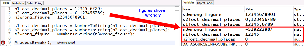

First to say, I'm verry happy to have that good basic TI Debugger and editor now, verry important for TI developers.
But, I found some bugs and could not foreward them to IBM - please, does anyone have the chance to forward it??

(1) numbers are displayed in variables tab without decimal places (0.1234 => 0 or 1234.56 => 1234).

See attached sample of wrongly shown figures out of Turbo Debugger.
