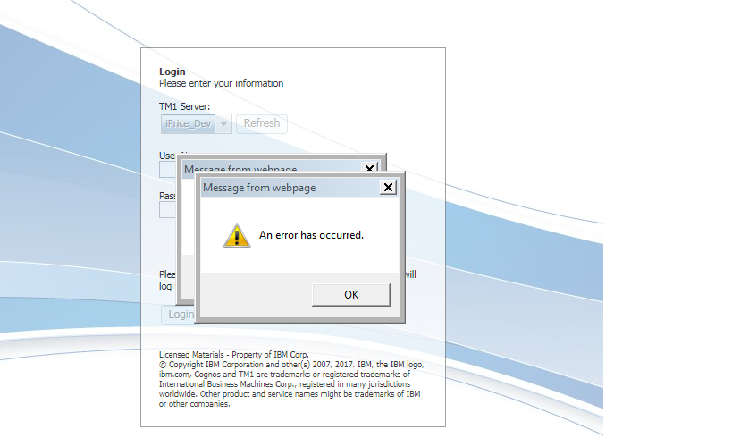

Many thanks for your suggestions.
Specifying the port numbers in Windows firewall Advanced security got the application name in place. But it is still grayed out, and then shows an error has occurred in the login page.
Tried all suggestion is posts http://www.tm1forum.com/viewtopic.php?t=9529 and http://www.tm1forum.com/viewtopic.php?t=9926. Still no luck
The Application is up and running. Tried in all browsers in multiple systems.
Also Re-checked the admin host in fpmsvc_config.xml. It shows the right value.
- Issue_Login.png (113.38 KiB) Viewed 12448 times

Re: Application name not listed in TM1 web URL
Have you checked that all of the firewall ports are open?
Unable to log in to Architect/Perspectives/TM1 Web: TM1 server is not showing
and just to be sure on the tm1web side of things:
TM1Web does not show any TM1 Servers in the server dropdown
Can you confirm if you are able to login via Architect/ Perspectives/ Performance Modeler and which version of Cognos TM1 you are using (or more specifically; IIS or Tomcat)?

Also, what does tm1web.log say?

Issue resolved temporarily. IBM guys suggested to add the ip address in the tm1s.cfg file. Somehow the server is currently having two ip addresses. When added them in the tm1s file, it works.. but this should not be the resolution ideally.
