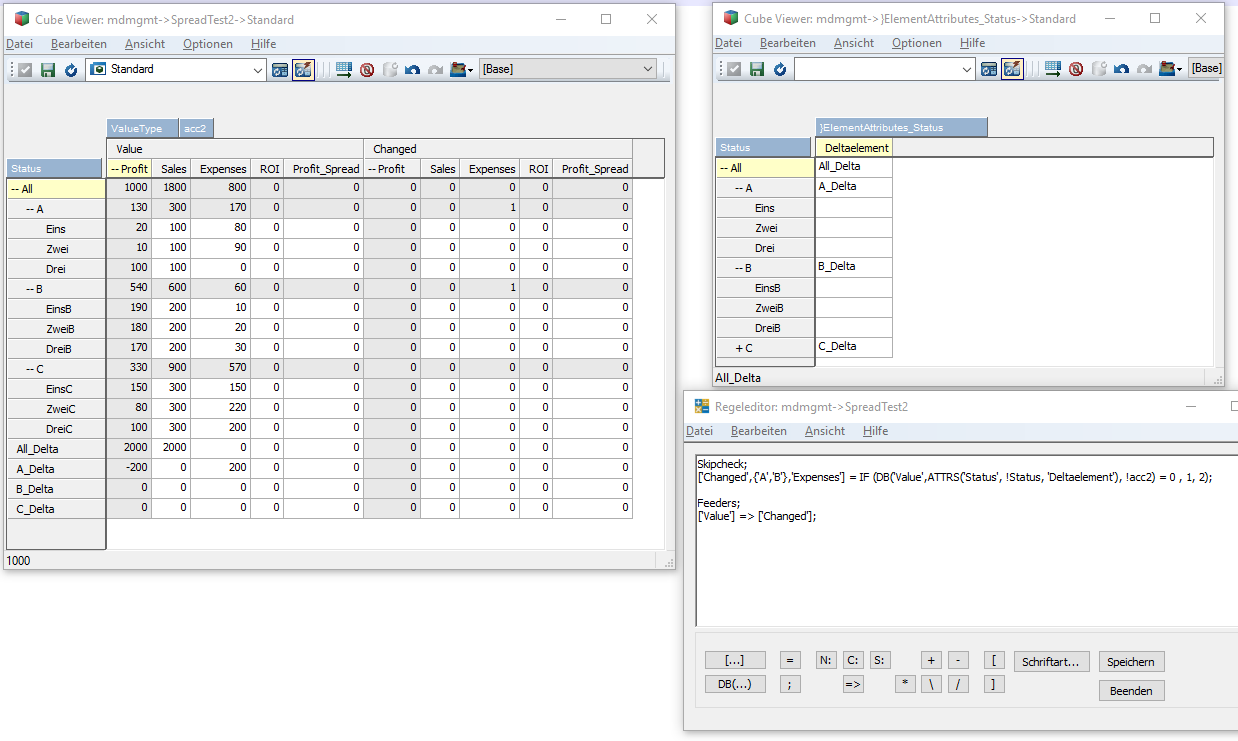

Hope somebody could throw a light on my misunderstanding:
I try to implement a spreading procedure and first of all I want to have an indicator for changes at all (by rule).
I attached a picture showing the cube, the attributes cube assigned to the main cube and the rule:
['Changed',{'A','B'},'Expenses'] = IF (DB('Value',ATTRS('Status', !Status, 'Deltaelement'),'Expenses') = 0 , 1, 2);
The attribute is correctly resolved as 'A_Delta' resp. 'B_Delta', and I can save the rule and refresh the cube viewer without errors.
But the cell Valuetype=Value,Status=A_Delta,acc2=Expenses contains '200', which is != 0, so I'd expect the rule to get a result of '2' here, where ValueType=Changed, which should be the indicator to process the A_Delta afterwards.
I fear it is a very 'dummy' question, but I didn't find something similar in the historic posts...
(The xy_Delta-cells are intended to take input in a websheet, later these inputs should be spreaded via TI instead of immediately via contextmenu spreading methods.)
Misunderstanding of the correct FEEDER, maybe?
Stefan
Check your syntax on this rule. The proper syntax when using DB to reference a cube is:
DB('Name of Cube', Dim1, Dim2, Dim3....Dimx)

Aaarghh, indeed it WAS a dummy question, just oversaw the missing cubename in DB-formula while thinking around potential errors in ATTRS.
Sorry for polluting the forum and thanks for the hint... :oops:
