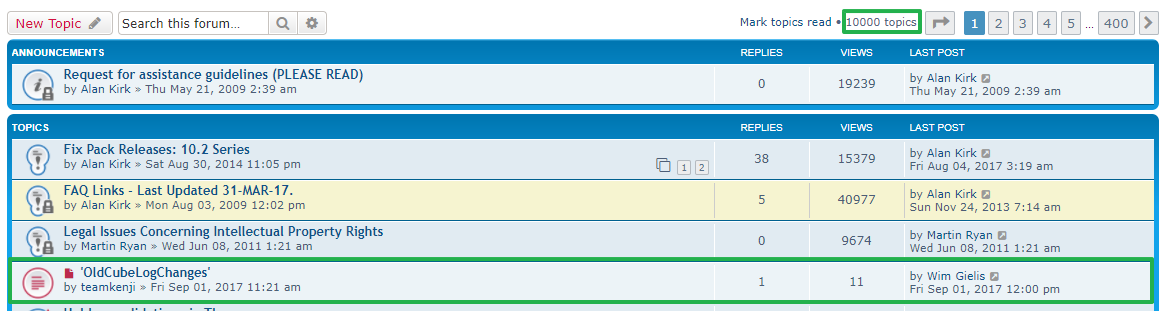

Welcome Ben, congratulations, your 1st post is the 10000s topic in TM1 forum (without subforums)!!
