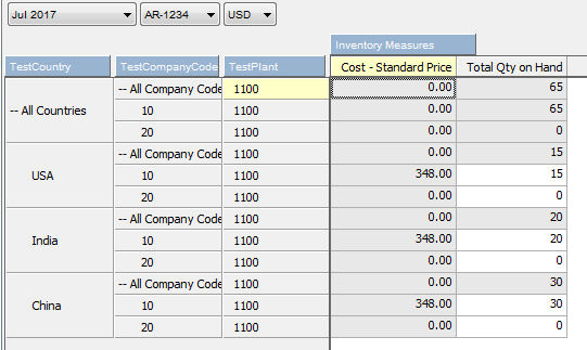

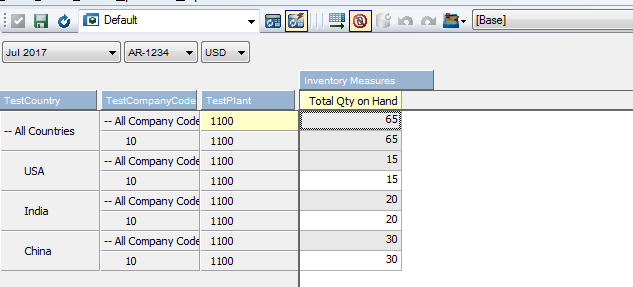

I am facing the issue you stated below , doing zero suppression removes the entire Cost - Standard Price column from the view , even though the rule calculated value is present in the intersections .
Attached the screenshot after and before zero suppression is turned on .
SKIPCHECK;
['Cost - Standard Price'] = N:DB('Cost Sets',!TestPlant, !TestCompanyCode, !Currencies, !Months, !TestItems, 'Standard', 'Cost - Standard Price');
Feeders;
['Cost - Standard Price'] => DB('Cost Sets',!TestPlant, !TestCompanyCode, !Currencies, !Months, !TestItems, 'Standard', 'Cost - Standard Price');
Source has 6 dimensions and 5 dimensions in the cost sets cube to retrieve the cost value.

- without zero supression.png (16.62 KiB) Viewed 35361 times
- With Zero Sup.png (21.77 KiB) Viewed 35361 times

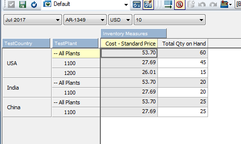

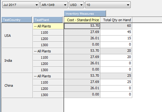

Okay , I have written the feeders in the source cube now . Bit I am not getting the complete correct result .
Now Zero suppression still shows me the cost .
but my question is cost has no relation with quantity , why does cells with zero quantity gets suppressed even it has cost .
Just trying to understand the basics .

- Before Zero Suprrssion.png (17.04 KiB) Viewed 35231 times
- AfterZerosupression.png (20.33 KiB) Viewed 35231 times
