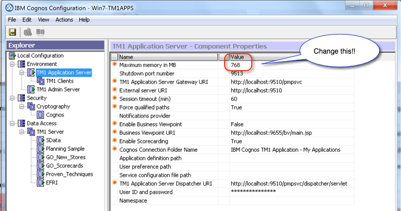

IBM said
The JVM for TM1Web needs to be increased. The default is set to 768mb which is usually too low. Most of our customers set to around 8GB. Here's where you update this parameter: http://www-01.ibm.com/support/docview. ... g27041876
However we believe a different setting is actually changes the max java heap size.
Q2. What is the difference between these following settings? (the description is exactly the same). Do these settings have any relationship or impact to each other?
