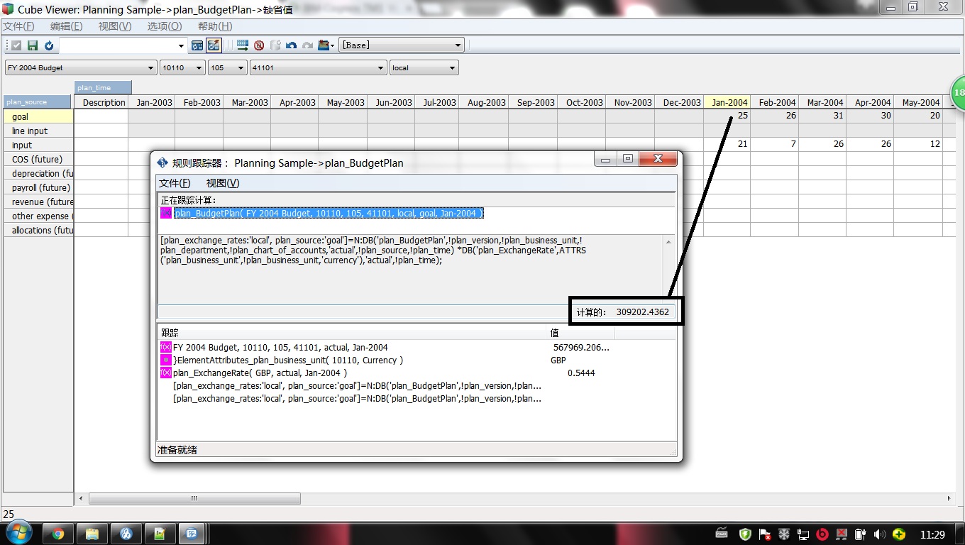

Hi experts,
did you know why tm1 cube view could not display real value?
It just like screen:

Could you please also mentioned the "Trace Feeder" calculations?
Can you do suppress zero and see whether same values appear for ("Jan-2004",Goal)=25?
If so then it looks like underfeeding.

Hi Dharav,
Thanks a lot for you reply.
Because this is planning sample cube, I do not think that it is feeder issue.
I did not change any planning sample rule and feeder and all of the application is same issue.
Do any experts what is it problem?
Thanks a lot.

Re: Tm1 cubeview display value incorrectly
What formatting have you got specified for the measure?

Hi Declanr,
Thanks a lot.
I have not amend any format for these view.
There are no any change after I tried to adjust the format of cubeview.
[img]
[/img]
Believe you must have formatting set on one of the dimensions rather than the view?
