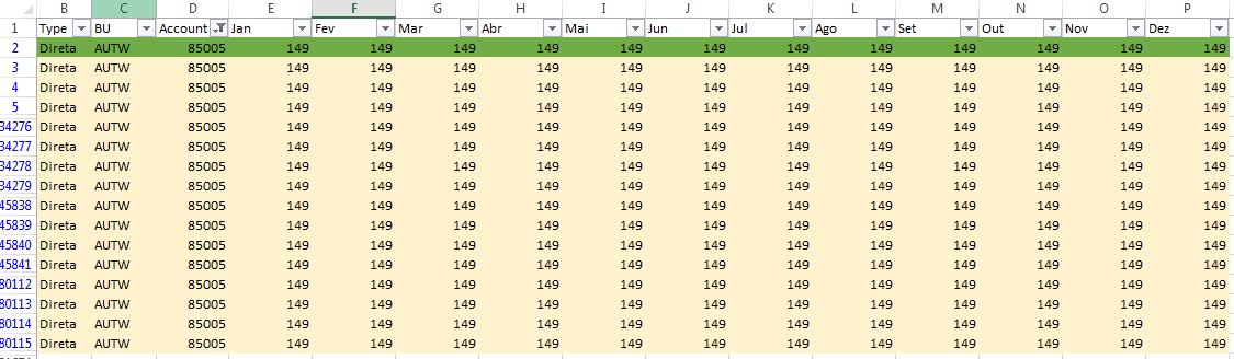

I did that, but now it is coming 16 rows with repeated values.
Here my code:
My data source view has only "Total of Months" on period dimension. No leaf elements.
Here the result of the flat file for one data point to give the example about what is happening:
[img1][/img1]
I was expecting to bring me only the green row, where I have the months on columns. But all the yellow rows are duplicated and repeat the values for the account each month.
This is the problem. I have read the post and still don't know what to do.
[img1][/img1]

Look at the Prolog tab and the view as the data source of the process.
You have a view defined on a cube with 9 dimensions.
Where in the csv output file do we see the dimensions that are not month, type, BU ?
Your AsciiOutput contains too little information (columns) and therefore if you have multiple records that appear to be the same, they in fact relate to other elements in the dimensions that you do not put in the file.

Re: Export Cube data in CSV file, with all Months as columns
Hi Wim!
The cube in fact has 9 dimension, but on my flat file I only want only some of them.
But the other dimensions has only one element for each row of the flat file, so I do not think that is the problem, but I will a export with all dimension to see what happens.

Wim Gielis wrote: ↑Tue Jul 16, 2019 10:41 pm Look at the Prolog tab and the view as the data source of the process.

tomok wrote: ↑Wed Jul 17, 2019 12:09 pm If you employ the method in this thread you will have to explicitly define subsets for every dimension in the cube you are using as the data source. Since you have to turn off "Skip Consolidated Values", if you don't specify a subset for a dimension you will get every element in the dimension in your view, including consolidated nodes, which can result in duplicate records (one record for the leaf and then x number of records for each parent it rolls to. Go back to your view definition and make sure you have appropriately defined subsets for each dimension. There is about a 99% chance this is your problem.

Hi guys.
I have changed the source view and put all subsets that I don't want on flat file on total.
The other dimensions that I want I put all leaf elements.
On the source view am not skipping consolidated values.
Doing this it worked fine!
Thanks a lot for everyone that helped me.
Best regards.
JR
