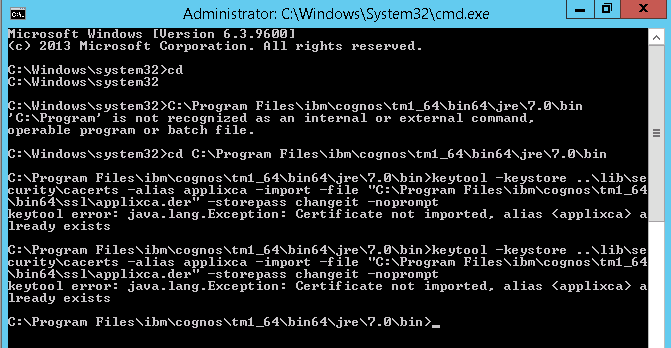

prasad
Posts: 4
Joined: Wed Oct 19, 2016 8:47 am
OLAP Product: Cognos tm1
Excel Version: 10
Re: SSL breaks on Nov 24
Post by prasad »
Thanks for your reply
As I have mentioned before we have updated the SSL certificates in the TM1 application server ,Now It shows up expiry date 17 June 2016 to 15th Jun,2024 by following steps given by below link.
Link: http://www-01.ibm.com/support/docview.w ... wg21991546
Same steps we are following for web server update. but am stucked at step no 10
Update Java keystore
Open Command Prompt as Administrator
cd C:\Program Files\ibm\cognos\tm1_64\bin64\jre\7.0\bin
keytool -delete -alias applixca -keystore ..\lib\security\cacerts -storepass changeit
keytool -keystore ..\lib\security\cacerts -alias applixca -import -file "C:\Program Files\ibm\cognos\tm1_64\bin64\ssl\applixca.der" -storepass changeit -noprompt
for more information, I have attached the screen shot for the same...
Can you please look in to it and give me the suggession.
Thanks in advance
vovanenok
Posts: 89
Joined: Mon Jun 23, 2014 4:54 pm
Version: 2.0.9
Location: Toronto, Canada
Post by vovanenok »
prasad wrote:Thanks for your reply
Thanks in advance
you have to execute this first:

prasad
Posts: 4
Excel Version: 10
Post by prasad »
Thanks for your reply.
Thanks Dsproffitt and vovanenok.According to your suggestions we have updated the certificates both at TM1 application server as well as TM1 web server. Now, we are facing another issue. TM1 support team mainly use Architect whereas business uses TM1 web. Now, the client team is unable to connect to perspectives with a client configured with the old certificates, this way they want to connect by using either an old or new Perspective client. One of the client team has admin access for TM1.
We have followed the step mentioned here for 10.2.2 FP1 :
http://www-01.ibm.com/support/docview.w ... wg21991546 which I think replace new certificates with old certificates.

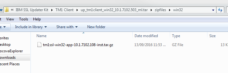

We updated all of our environments (development, UAT, production, end users, admins & developer machines) this past weekend. Here are some observations; Maybe some/or all of below is well known by now, so apoligies if it is redundant.
Version: TM1 10.1.1
Authentication: Cognos (CAM)
Edited:
- I used the SSL versions that come with the SSL Updater Kit which are in the file shown in the image attached. As we'd know by now, all .tar and .gz files can be opened using 7Zip or any other file compression utility.
- If you are going to update client (Perspectives and/or Architect), you have to update all your environments otherwise the serves with old certs will not be displayed in the client after you have applied the updated certs.
- After applying the new SSL certs, all components are running (TM1 admin server, server, tm1 web) and these are displaying in the clients that have the new certs. Ops Console however is an exception. Though I've updated the certs in the "<tm1_install>\webapps\pmpsvc\WEB-INF\bin64\ssl" folder as well, but no luck.
- We have NOT updated any certs in Cognos, as we are moving away from Cognos BI, and will leave the basic Cognos installation for the sake of CAM authentication in TM1. Not sure if the above Ops Console issue is somehow related to it.
- For rolling out to end user machines ,we engaged IT to come up with a PowerShell script and cater for 32 bit & 64 bit environments (program files (x86) on 64 bit and program files on 32 bit). Also if you have users with Surface Pro running Windows 10, there's an odd error that Power Shell scripts run into, something related to Printers. If you want I can get you the details from our IT guy.
All in all, we are now waiting for the 'Day day', i.e. 25 Nov 2016 to see how it goes. Hopefully no surprises then.
