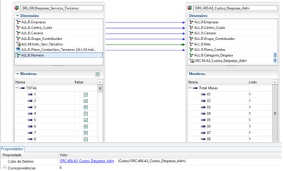

I am facing a problem using the link on Performance Modeler. After all links done I don't see the numbers of source cube on destination cube.
Does anybody know what can be the problem?
Find attached an image where is possible to see the link done on Modeler.

Hi Jorge,
1. Close the Performance Modeler;
2. Open TM1 Architect;
3. Open the rule generated by Performance Modeler;
4. Delete the generated rule and write the correct one.

Hi everyone!
Thanks for the answer.
In this case I did the destination cube again and it works!
This case it would be hard to write the rule because I was using a picklist on metrics dimension and performance modeler give me a easier way that writing rules.
