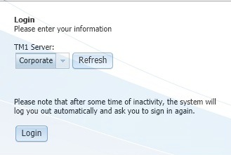

We have four different Tm1 Server (instances) on our application server (10.2.2 FP3 with CAM security) which get listed alphabetically in the TM1 Web Login page. The page always defaults on the first one in the alphabet "Corporate". We were wondering if it is possible to have another Tm1 server show as default choice in the drop down list.
We saw that it is possible to set a Default Tm1 server in the webcofig file but that would also, i think, remove the tm1 server down down list? We would like to keep the drop down but just set it to our second server in the list "E-Corporate" to show as default. Is that possible?
Thanks for any support.

Re: TM1 Web login: How to set a default TM1 server
Thanks BariAbdul for your reply.
In the webconfig this can be entered:
<add key="TM1ServerName" value="ServerName"/>
•If ServerName is set to a valid TM1 server name, then the login page does not display a prompt for either the Admin Host or the TM1 server.
... meaning that it would just preset a tm1 server and disable the drop down completly. We would like to keep the dropdown but preset a default instance to be selected when the login page opens. This might seem like overkill but with hundreds of people loggin in on the solution quite a lot of people leave it wrongly on the default.
If there are no standard settings i guess this is hidden in some jsp files?
Open the ibm\cognos\tm1_64\webapps\tm1web\scripts\tm1web\standalone\TM1WebApp.js, and search this._serverNameSelect.set("value",a[0].value), and change 0 to 1
