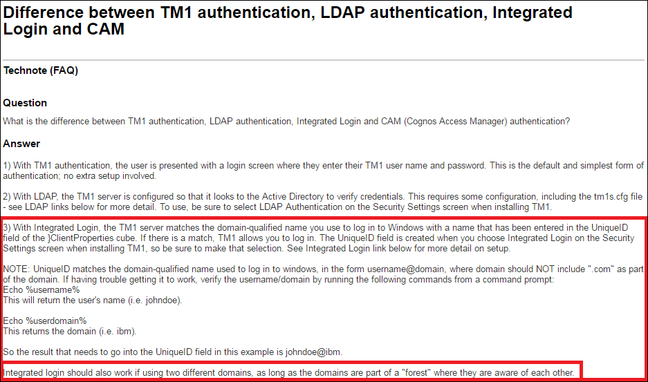

According to an IBM reference, we've added the user (from another domain) in TM1 as <username>@<userdomain>.
However, when we tried to integrated login, it prompted message 'Log In Failed: SystemServerClientNotFound'. :(

We use multi-domains successfully, so I can confirm it's possible. My advice would be to open a ticket with IBM on this one. Kerberos logging can be difficult to trace. I had an issue with Kerberos integrated login on TM1 Web and it took over a year and a dozen meetings w/ IBM before we finally found the right person to figure it out (bizarre issue, one of the files had been saved with the wrong encoding).
