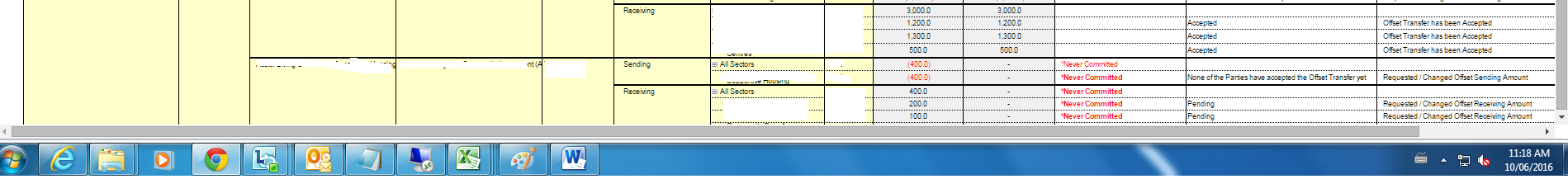

I am having an issue with TM1Web, so I have a websheet that contains an active form and at the bottom of Active Form I have a few Static rows ( to show some Totals )
The problem is that when the Active Form exceeds a certain number of rows, eventhough the vertical scroll bar shows, TM1Web does not render the bottom of the websheet. Depending on the number of rows the Active Form returns, sometimes it does not render the last rows of active form, and also the static rows I have underneath, but if I zoom out ( Control / minus ) a few times, then all the websheet rows show
Our TM1 Build Number is 10.2.20400.80
This is happening with both, IE and Chrome
Has anybody experienced this issue?
TM1Web Truncating Issue.png (109.64 KiB) Viewed 5908 times

Thank you Jim but it also truncates the content of Active Forms itself. The row in the Bottom of Active Form is a requirement to show the Totals, and because I am nesting many dimensions in TM1RPTROW columns, then I dont want to Include the Totals in Active Form because of so many combinations of Subtotals
Attach screenshot shows now the last lines of Active Form itself have been truncated
TM1Web Truncating Issue 2.png (49.76 KiB) Viewed 5884 times

I was doing some more testing and I it looks like the issue happens when one of the columns in the active form is wrapped and the text breaks in multiple rows. So the height growth of the “Websheet” does not accommodate the “line break” for the wrapped cells.
If none of my cells is wrapped, then I can keep adding as many rows as I want and the websheet will accommodate all the rows. But wrapping seems to create this issue.
This is just an observation so I thought I should share it with you
