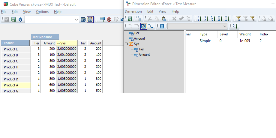

Hi Guys,
Following my previous post, I can confirm that SubsetToSet didnt return desired results.
I played around with Generate, but didnt have any luck either. However, following Declar's logic, this workabout should address your issue in the interim (not elegant either):
1. I used simple MDX: {ORDER({TM1SUBSETALL( [Product] )},[MDX Test].([Test Measure].[Sys]),BDESC)}
2. Created consol Sys
3. Gave amount a weighting of 0.00001
[img]
MDX Order.png (36.76 KiB) Viewed 10499 times
[/img]
However, not that versatile and lacks an ability to do DESC by Tier and ASC by Product simultaneously
