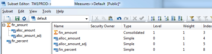

Maybe I don't understand something about feeders, that's why I'm asking.
I have the measure dimension:
fin_percent is calculated using a rule:

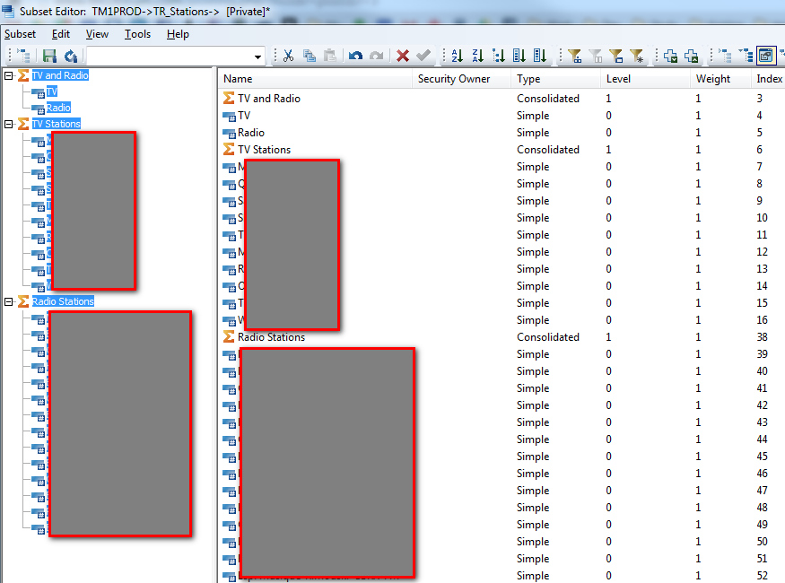

Finally Station dimension looks like:
alloc_amount for TV and Radio is copied from TV Stations and Radio Stations consolidations by TI process (for performance optimization), so fin_amount for each station including TV and Radio elements should be always fed if there is any value for alloc_amount, consequently fin_percent should be fed as well.

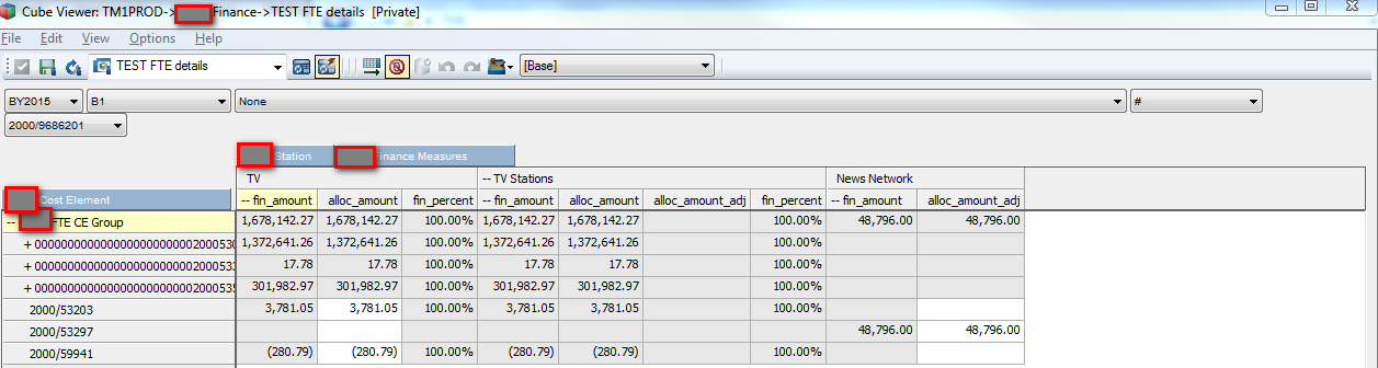

However I have a problem with one TV station, for some reason when look at its fin_percent at FTE CE Group ("Cost Element" dimension consolidated element), it displays the right value: 2.91%
also when I click check feeders it shows that it's fed, but when I suppress zeroes that fin_percent disappears, so in fact it is not fed.
What am I missing here?
After zero-suppression:

I think you are running into trouble with C level rules and feeders.
Feeders only happen at the N level, think ticks in a box that says calculate me.
C level cells are only "fed" if at least one cell under it is fed and non-zero.
So in your first view in the second post, since there is no value under the problem cell (that I can see in the screen shot). The C level cell is not "fed" and so does not display.
