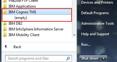

Re: TM1 shows installed, but no IBM Cognos folder or Architect found after installation
Post by shreyasohan »
Please see the image in the attachment. This is what is happening. Tried uninstalling and reinstalling but nothing works.
Tm1 error
Tm1 error
