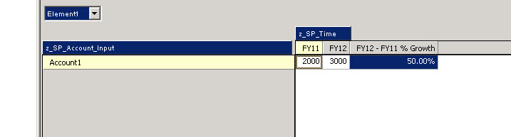

In Cognos EP the calculated cells provide you the ability of editing them and then breaking back the changes to source cells.
I am trying to replicate the same functionality in TM1 using rules as described below:-
Rule on the cube: ['FY12 - FY11 % Growth']=N:(['FY12']-['FY11'])/['FY11'];
Although the actual requirement is much more complex but let's assume that the requirement is that there is a hold on FY11 data and the user can change the FY12 data or the Percentage column. If the user changes value of FY12 data, the percentage column should change and if the user changes the value of percentage column, then the value of FY12 column should change. Since the break back does not work here as the rule calculated cell is read only, is there any workaround to achieve this?

@Lotsaram - I have tried writing a rule with just one variable but even then I can't update the rule calculated cell.
For example, if the rule says ['FY12']=N:2*['FY11'] and I try to update the cell ['FY12'], I still get data spread failed. Ideally I would expect it to update the value of cell ['FY11']. Am I missing something?
