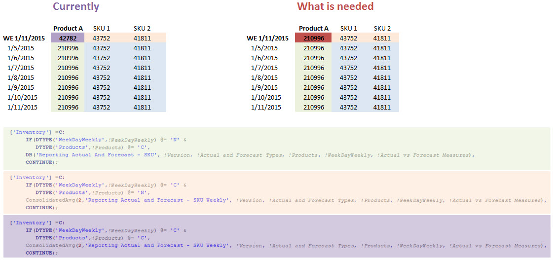

Hi everyone,
I've been reading through everything I can find on ConsolidatedAvg in the forum and have tried all sorts of different things and I just can't seem to get this to work how I need so I am breaking down and submitting a question to the forum :)
I have tried changing the order of my dimensions, I have tried different order of my rule, I've tried adding "ConsolidateChildren('WeekDayWeekly')\ConsolidatedCountUnique(0,'WeekDayWeekly'...." to the rule below I have in purple, etc. but I just can't seem to get this to work :(
I have illustrated below what is currently happening with my rule and then how I need it. I highlighted the rule showing what portion is affecting what part of the cube. Thus, I believe I have to do something to the Purple shaded portion? Or, am I just way off base?
Any help would be greatly appreciated! Thanks a lot!
Actual code vs screenshot:
['Inventory'] =C:
	IF(DTYPE('WeekDayWeekly',!WeekDayWeekly) @= 'N' &
        DTYPE('Products',!Products) @= 'C',
	DB('Reporting Actual And Forecast - SKU', !Version, !Actual and Forecast Types, !Products, !WeekDayWeekly, !Actual vs Forecast Measures),
	CONTINUE);
['Inventory'] =C:
	IF(DTYPE('WeekDayWeekly',!WeekDayWeekly) @= 'C' &
	   DTYPE('Products',!Products) @= 'N',
	ConsolidatedAvg(2,'Reporting Actual and Forecast - SKU Weekly', !Version, !Actual and Forecast Types, !Products, !WeekDayWeekly, !Actual vs Forecast Measures),
	CONTINUE);
['Inventory'] =C:
	CONTINUE);

By george, I think I may have gotten it!! This appears to be working! :D :D
I changed my last section (the section in purple) to the following:
['Inventory'] =C:
	IF(DTYPE('Products',!Products) @= 'C' &
	   DTYPE('WeekDayWeekly',!WeekDayWeekly) @= 'C',
	ConsolidateChildren('WeekDayWeekly') \
	ConsolidatedCountUnique(0,'WeekDayWeekly','Reporting Actual and Forecast - SKU Weekly', !Version, !Actual and Forecast Types, !Products, !WeekDayWeekly,  !Actual vs Forecast Measures),
	CONTINUE);
Does this look okay? :)
Posts: 1458
Re: ConsolidatedAvg
Post by David Usherwood »
Why not consolidate 1 up the tree then set the average to be the total divided by the count?
