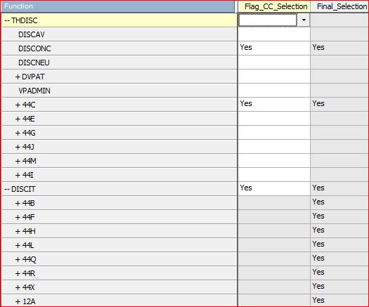

I am trying to clean cube data based on a dimension hierarchy for a specific roll up. Created one TI with coded embedded as :
vFunctionDimNm = 'Function';
nDimCount = DIMSIZ(vFunctionDimNm);
nElementCounter = 1 ;
WHILE ( nElementCounter < nDimCount + 1);
vElementNm = DIMNM(vFunctionDimNm, nElementCounter );
vValue = CellGetS('RDEXSL_Pln_Upd_CC_Select', ELPAR( vFunctionDimNm, vElementNm,1), 'Flag_CC_Selection');
nCheck = ELISANC(vFunctionDimNm, 'THDISC', vElementNm);
IF( nCheck = 1 & vValue@= '');
CellPutS('', 'RDEXSL_Pln_Upd_CC_Select', vElementNm, 'Flag_CC_Selection');
ELSE;
ItemSkip;
EndIf;
nElementCounter = nElementCounter+1 ;
END;
In attachment you can see the structure of cube and the goal i am trying to achieve but some how it is not working. Not sure where i am failing, so need your help.

Re: Data Input clean up based on Dimension Hierarchy
Did you debug the code using AsciiOutput or TextOutput or LogOutput ?
Quickly looking at your code, I see an ELPAR which can sometimes be the cause of issues if one element can have multiple parents.
Just a thought, please debug your code and keep this in mind.

The problem seems to be in logic, not in counter initialization and in loop. If i use code:
IF(vValue@= '');
ELSE;
ItemSkip;
EndIf;
END;
It works fine for all elements of dimension. But the requirement is to run it for specific parent. Any help would be appreciated.
You could insert an IF test in the loop, With the ELISANC function. That function allows to execute your code only on 1 part of a dimension.
