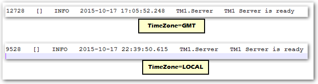

We have both of them (Timezone, Stargate) working in our dev environment. I did a quick test with a brand new TM1 instance and verified that, setting the TimeZone to local, actually changes the timestamps in the tm1server.log to the local timezone. See screenshot, attached.
tm1s-log.properties needs to be in the same folder where tm1s.cfg is present. Can you confirm where you have placed the tm1s-log.properties file?

Local Timezone logging works, or at least I have never seen it not work. The link to the documentation you posted is referring to the transaction log file; the tm1s.log. NOT the tm1server.log (message log).
The message log can be changed to local time. The transaction log can't. That's what the documentation is meaning.
Note that although most config changes to tm1s-log.properties are picked up instantly the Timezone toggle does require a restart of the tm1 instance to take effect.
