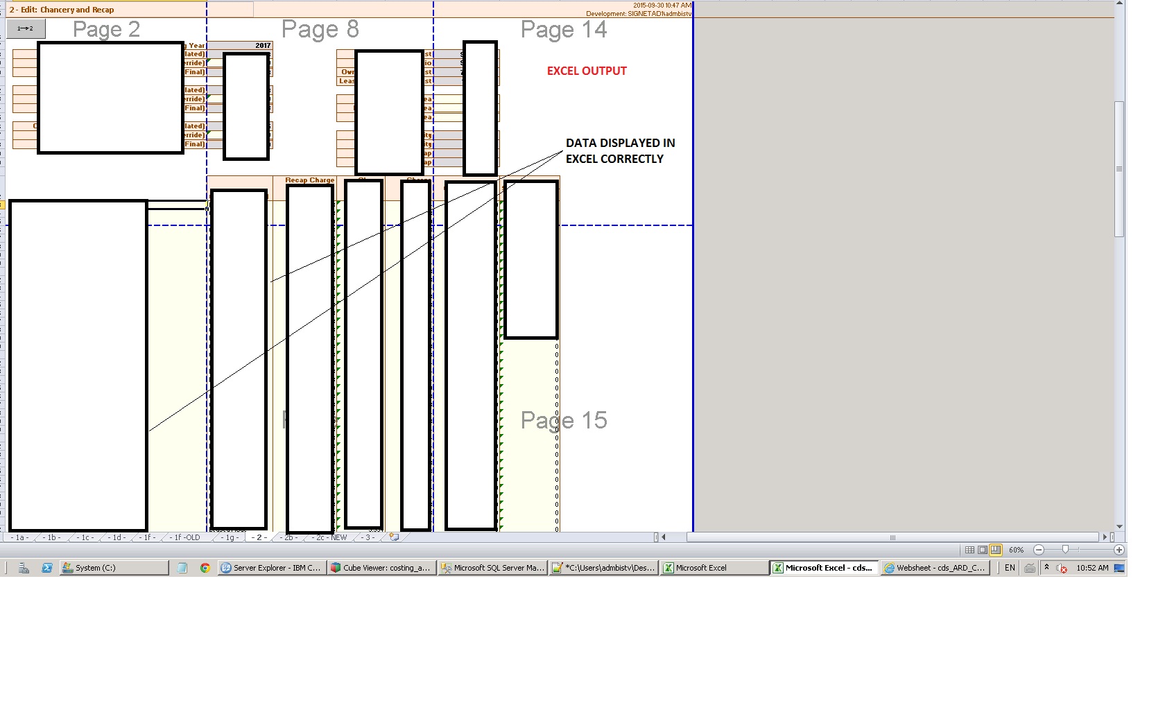

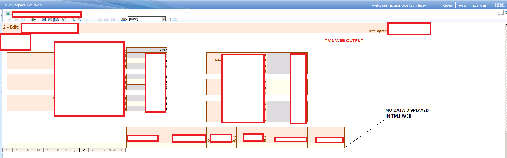

I have recently ran into an issue where a TM1 Excel report runs and shows correct numbers but when the report is published to TM1Web it only shows partial data. In this case, the data sources feeding the report are two cubes - a main aggregate cube and another cube that feeds line item data. The aggregates show up on TM1Web fine, but the section that is defined via TM1RPTROW expression does not appear on TM1Web (again works fine in TM1 perspective). We are on 10.1.1 environment.
Attached are the two images showing the issue at hand.

I noticed that the TM1RPTVIEW call was referencing another server which TM1 Perspective was able to connect and get the subset data, whereas the TM1 Web could not so it displays nothing.
