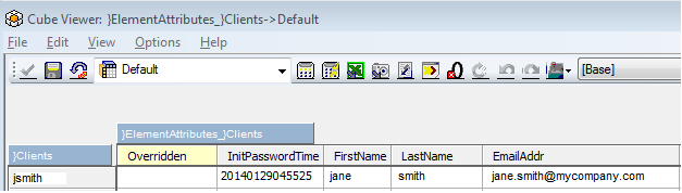

Thought I'd make use of the expiry feature that still hasn't changed (after all these years) by running a chore.
Idea is to record a copy of the 'PasswordLastTimeUpdated' in a new }Client attribute then compare date-time differences to see
1. If user has changed password (time-stamp variance)
2. Days passed since password was set (Now - 'PasswordLastTimeUpdated')
and delete the Client's expiry if the password was changed so it doesn't lock them out or continue to nag them.
my example:
tm1server:}Clients->All
#(Prolog)
# This process is designed to scan all Clients and check for 'InitPasswordTime' attribute [created by admin]
# and execute the data tab section otherwise skip Client.
# the Client's 'InitPasswordTime' attribute MUST be the same date-time as 'PasswordLastTimeUpdated'
# in }ClientProperties at the time when their initial "temporary" password was set when new user was
# created
# }ElementAttributes_}Clients
#       - FirstName, EmailAddr
# }ClientProperties
#       - PasswordLastTimeUpdated
#       - PasswordExpirationDays
#           - [ check SecurityAdmin access is ticked for this process eg: as chore ]
FilePath = 'E:\Cognos\TM1\Custom\TM1Data\tm1server\TM1LogFiles\output_text\';

pwdControlS = Attrs('}Clients', vClient, 'InitPasswordTime');
# *new Get expiry days and check against pwd time if manual override occured
pwdDayS = CellGetS('}ClientProperties', vClient, 'PasswordExpirationDays');
If (pwdControlS @= '');
    ItemSkip;
ElseIf (pwdControlS @<> '' & pwdDayS @= '');
    AttrPutS(pwdControlS, '}Clients', vClient, 'Overridden');
    AttrPutS('', '}Clients', vClient, 'InitPasswordTime');
    vFirstName = AttrS('}Clients', vClient, 'FirstName');

If (recCount > 0);
    aTo1 = '-t tm1dude@mycompany.com';
    aSubject = '-u TM1 New Client _ Password Monitor';
    aBody = '-m No password change :=' | NumberToString(vCount) | ' of ' | NumberToString(recCount) | ', Expiry cleared :=' | NumberToString(xCount);
    aAttach = '-a ' | FilePath | FileName | '.txt';
    CmdStr = aFilePath | ' ' | aFrom | ' ' | aTo1 | ' ' | aSubject | ' ' | aBody | ' ' | aAttach | ' ' | aMailServer;
    ASCIIOutput(FilePath | FileName | '_Epilog.txt', 'Cmd:= ' | CmdStr);
    ASCIIOutput(FilePath | FileName | '_Epilog.txt', 'Pwd Ctl:= ' | pwdControlS, Subst(pwdControlS, 1, 8) | '_' | Subst(pwdControlS, 9, 6));
    ExecuteCommand (CmdStr , 1);
EndIf;
# Invalid Client entered as parameter
If (Dimix('}Clients', pUid) = 0);
    ProcessQuit;
EndIf;
pwdTime = CellGetS('}ClientProperties', pUid, 'PasswordLastTimeUpdated');
AttrPutS(pwdTime, '}Clients', pUid, 'InitPasswordTime');
* to enforce password changes for existing set of users, (Now - 'PasswordLastTimeUpdated') will need to change to like ~ (Now - 'WhenExpiryDaysWasSet').
