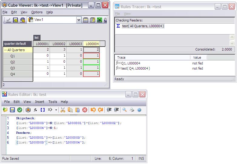

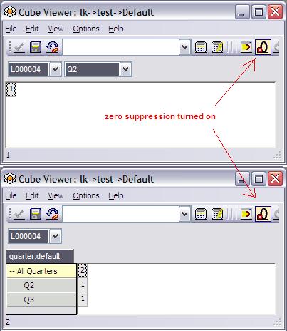

jstrygner
- Posts: 195
- Version: 9.5.2 FP3
Re: Calculated Zero Cells and Feeders
Nicola,nicola531 wrote: Do Calculated cell, when their value is zero, feeders other cells if they are feed?
I found your question very interesting and to answer it I decided... to check it
I think attached picture shows, that fed cells that calculate to zero still feed other cells - the Q2 row shows that.
HTH
- FeedFromCalculatedZero.JPG (65.17 KiB) Viewed 31691 times

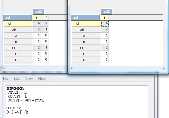

- Michel Zijlema
- Posts: 713
- OLAP Product: TM1, PALO
- Location: Netherlands
The attached picture illustrates the behaviour that I was referring to in my first post in this thread.
Left is non zero-surpressed view, right view is one with zero-surpression. Although all leaf cells of the 'L2' element are fed, the column disappears when zero-surpression is activated - the zero cells are treated just as zero cells, fed or not.
Michel
Michel
- Feeder_Zero_test.jpg (62.83 KiB) Viewed 31678 times
jstrygner
- Posts: 195
Michel,Michel Zijlema wrote:So at this moment I don't see what your test exactly is proofing.
I think we interpreted Nicola's question different and that is why we gave totally different responses.
My interpretation of the question was:
- Let's assume we have a leaf cell that is calculated.
- Let's assume this cell feeds another leaf cell.
- If the first cell value is calculated to non zero it is obvious that it should feed this other leaf cell.
- But if the first cell value is calculated to zero will it still feed this other cell?
And IMHO my example shows that yes, the feeder will still fire, and I think that was Nicola's question about.
No.Michel Zijlema wrote:Is zero surpression activated in the view in your screenshot?
My interpretation of Nicola's question is the same as yours. That is if a fed cell has a zero value will it in turn feed other cells?jstrygner wrote:Michel,Michel Zijlema wrote:So at this moment I don't see what your test exactly is proofing.
However, your analysis is not correct, as indicated by your response to Michel's question of whether the view in your image was zero suppressed. Whether a leaf cell calculates the correct value has nothing to do with whether it is fed or not. If the cell value is directly queried then the rule will still be evaluated. To check whether the cell is fed, right-click the cell and select check feeders. If you did this on the intersection of Q2 and L000004 the resulting window should indicate that the cell is not fed. To refine your example create a view containing only the intersection of Q2 and L000004, zero suppress the view and there should be no value, this indicates the cell is not fed (although it evaluated to 1). The purpose of feeders is not to assist leaf cells to be correctly evaluated but rather to mark leaf cells as having a value so that consolidated cells will evaluate to the correct value.
Expected behaviours is that if a rule calculated cell evaluates to zero then it will not feed any further cells. At least that's what I have always observed.
jstrygner
- Posts: 195
lotsaram, I'm affraid have to disagree with some of your statements.
There was nothing in my post that would suggest something different.
And the screenshot of the check feeders is there on the picture I attached to my first post of this thread and it shows that there are two cells that are not fed: ['Q1', 'L000004'] and ['Q4', 'L000004'], which indicates, that the remaining two (['Q2', 'L000004'] and ['Q3', 'L000004']) are fed.
My test just assured me in my thoughts.
As we know TM1 tends to behave different between versions without mentioning about it in documentation, so it is possible you could observe different behavior.
My test was done on 9.5.1 HF17, Windows 32 bit.
Regards.
100% agreelotsaram wrote:Whether a leaf cell calculates the correct value has nothing to do with whether it is fed or not. If the cell value is directly queried then the rule will still be evaluated.
To check if cell ['Q2', 'L000004'] is fed I did select the check feeders operation. But I did not do it on the leaf cell, as you suggest (so not on the ['Q2', 'L000004']), but I did it on a consolidation (where is the right place to do it, so in my example it would be ['All Quarters', 'L000004']).lotsaram wrote:To check whether the cell is fed, right-click the cell and select check feeders. If you did this on the intersection of Q2 and L000004 the resulting window should indicate that the cell is not fed.
The screenshot of a view is attached below (I also attach view where whole quarter dimension is shown to confirm what I showed in my previous post). As we can see ['Q2', 'L000004'] is there!lotsaram wrote:To refine your example create a view containing only the intersection of Q2 and L000004, zero suppress the view and there should be no value, this indicates the cell is not fed (although it evaluated to 1).
I was expecting exactly the opposite, but decided to make an example to make sure I give Nicola the right answer.lotsaram wrote:Expected behaviours is that if a rule calculated cell evaluates to zero then it will not feed any further cells. At least that's what I have always observed.
Regards.
- ViewsWithZeroSuppression.JPG (32.41 KiB) Viewed 31661 times

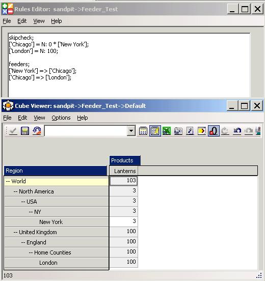

- qml
- Posts: 1098
- Excel Version: 2007 - 2016
I will have to agree with jstrygner on this one. Whether a cell calculates to 0 or not does not seem to influence its ability to feed further cells. If it is fed itself then it feeds.
My test was with 9.5.1, no hotfixes. In my example Chicago is always calculated to 0, but it does not stop it from feeding London. The view is zero-supressed and so Chicago is not shown, but London, fed from Chicago, is shown with no problem and fed, which Check Feeders confirms (not shown in my screenshot).
- yetanotherfeedercheck.JPG (43.81 KiB) Viewed 31629 times

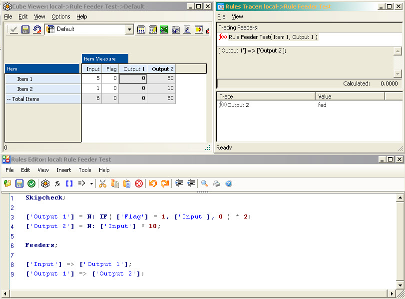

Weight of evidence is that a fed rule cell will on-feed regardless whether it's calculated value is zero or not. This isn't the behaviour I would have expected. I'll try and do my own quick analysis and have a serve of humble pie on the side this afternoon.
Tested in 9.5.1 and calculated value of zero still propagates feeders: I always try to avoid conditional feeders wherever possible, but this would be a case in point where it is absolutely necessary. Groan and d'uh.

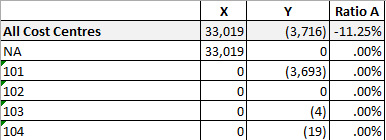

Hi everyone,
I came across with this post as I am having exactly the same problem as Nicola.
I am not sure if I misread all your previous replies but I don't think the issue of having the respective columns and/or rows disappearing when zero suppression is activated in a cube view was actually answered. I apologise if it indeed was
Below example is for a given Company code where a ratio formula is " Y / X = Ratio A " . This is only calculated at a Company level and not at the cost centre level basically due to the fact that variable "X" does not apply by cost centre hence it is allocated to a "NA" element as shown below. Variable "Y" applies to individual cost centres and the aggregated result is then used to workout "Ratio A" for a company. I would think feeders will be something like: ['X' , 'Y' ]=> [ 'Ratio A' ] , however when zero suppression is activated in a cube view Ratio A column/row disappears. Did I miss anything in your replies?
I would really appreciate any help
