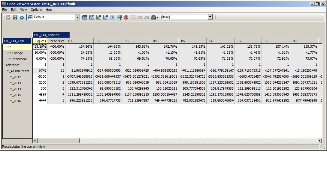

TM1 IRR Calc
Post by paulsimon »
Someone asked about doing an IRR (Internal Rate of Return) calc in TM1 on a Linked In forum. I answered it there, so I thought I would re-post it here in case it is of any use to anyone else.
This can be done in TM1 Rules or alternatively using an iterative WHILE loop in TM1 Turbo Integrator.
Whether it is worth the effort compared to using built in functions in Excel and storing the result in TM1 is debatable.
The following are the rules that prove it - sorry no feeders.
The convergence algorithm is noddy and there are better ones on the web
[img]
[/img]
['IRR','Figures']=['IRR','50'] - 1;
['Figures']=N:STET ;

You enter what you want in the Figures column. It does the iterations and returns the result in the [IRR , Figures] combination.
I tested it with an initial IRR Change of 0.1 and a Tolerance of 1 and the following figures in Y_2012 to Y_2016
-5000, 2000, 300, 4999, 4444
and the result was pretty close to the Excel IRR.

		,dimix( 'TY_DailyIRR_Payment', !TY_DailyIRR_Payment ) - dimix( 'TY_DailyIRR_Payment', 'All IRR Payment' )
		,0
['Residual Value','Payment Num'] =
	N:IF( ['Figures','Residual Value'] = 0, 0, ['Residual Value','PayCNT']-['All IRR Payment','ZeroCNT']);
['Payment Num'] =
	N:IF(dimix( 'TY_DailyIRR_Payment', !TY_DailyIRR_Payment ) - dimix( 'TY_DailyIRR_Payment', 'All IRR Payment' ) > 0
		,IF( ['Figures'] = 0
			,0
		,0
# Initial guess at IRR
['IRR','1st'] = N:ABS( ['All IRR Payment','Figures'] \ ['Initial Cash Outflow','Figures']  ) ;
# Basic second change
['IRR Change','2nd'] =
	IF( ['All IRR Payment','1st'] > 0
		,['IRR Change','Figures']
		,-1 * ['IRR Change','Figures']
# Later Changes until Tolerance reached
['IRR Change'] =
	N:IF( ABS( DB('TY_Daily_cIRR', !COM_Year, !COM_Month, !COM_Day, !COM_NoWithTotal, dimnm( 'TY_DailyIRR_Iteration', dimix( 'TY_DailyIRR_Iteration', !TY_DailyIRR_Iteration) - 1 ), 'All IRR Payment') ) < ['Tolerance','Figures']
	# N:IF( ABS( ['All IRR Payment']-1previous cell ) < ['Tolerance','Figures']
		,0
		,DB('TY_Daily_cIRR', !COM_Year, !COM_Month, !COM_Day, !COM_NoWithTotal, dimnm( 'TY_DailyIRR_Iteration', dimix( 'TY_DailyIRR_Iteration', !TY_DailyIRR_Iteration) - 1 ), 'IRR Change')
		#['IRR Change']-1previous cell
		*IF( DB('TY_Daily_cIRR', !COM_Year, !COM_Month, !COM_Day, !COM_NoWithTotal, dimnm( 'TY_DailyIRR_Iteration', dimix( 'TY_DailyIRR_Iteration', !TY_DailyIRR_Iteration) - 1 ), 'All IRR Payment') > 0
		#*IF(['All IRR Payment']-1previous cell > 0
			,IF( DB('TY_Daily_cIRR', !COM_Year, !COM_Month, !COM_Day, !COM_NoWithTotal, dimnm( 'TY_DailyIRR_Iteration', dimix( 'TY_DailyIRR_Iteration', !TY_DailyIRR_Iteration) - 2 ), 'All IRR Payment') > 0
			#*IF(['All IRR Payment']-2previous cell > 0
				,1.1
				,-0.1
				,-0.1
				,1.1
['IRR'] = N:DB('TY_Daily_cIRR', !COM_Year, !COM_Month, !COM_Day, !COM_NoWithTotal, dimnm( 'TY_DailyIRR_Iteration', dimix( 'TY_DailyIRR_Iteration', !TY_DailyIRR_Iteration) - 1 ), 'IRR') + ['IRR Change'] ;
['IRR Reciprocal']=N:1\['IRR'];
[]=N:['Figures'] * ( ['IRR Reciprocal'] ^ ['Payment Num']) ;
#FEEDERS;
# INITIAL SETTING FOR IRR
#['TotalSubsidy','Figures'] => ['Initial Cash Outflow', 'Figures'];
#['Financed Amount','Figures'] => ['Initial Cash Outflow', 'Figures'];
#['Total IDC','Figures'] => ['Initial Cash Outflow', 'Figures'];
#['IRR','59th'] => ['IRR','Figures'];
#['Figures' ] = N:STET ;
#['Tolerance','Figures'] => ['Tolerance'];
#Payment period Calculation for IRR
#['All IRR Payment'] => ['PayCNT'];
#['Residual Value','PayCNT'] => ['Residual Value','Payment Num'];
#['All IRR Payment','ZeroCNT'] => ['Residual Value','Payment Num'];
#['All IRR Payment'] => ['Payment Num'];
#['All IRR Payment','Figures'] => ['IRR','1st'];
#['All IRR Payment'] => ['All Iterations'];
#['IRR Change','Figures'] => ['IRR Change','2nd'];
#['IRR Change'] => ['IRR Change'];
#['All IRR Payment'] => ['IRR Change'];
#['IRR Change'] => ['IRR'];
#['IRR'] => ['IRR'];
#['IRR'] => ['IRR Reciprocal'];
#['Figures'] => DB('TY_Daily_cIRR', !COM_Year, !COM_Month, !COM_Day, !COM_NoWithTotal, !TY_DailyIRR_Iteration, !TY_DailyIRR_Payment);
I hide contract no element for security
But I used skipcheck & feeders But Saved not (I'm about to push save button and not repones.)
Re: TM1 IRR Calc
I'd suggest that you have a think about feeders and get straight in your head exactly what a feeder is and what its for.
You are simply telling the engine when the value is going to generate a non-zero result, generally it is the rule "backwards", but it doesn't have to be you can use whatever is convenient to flag the calc to take place. It also does not need to be 100% correct, you can over feed the values and providing you are happy with the calculation speed the job is done. (Under feeding is obviously bad as you get the wrong answer).
These two lines form the source of the calculations
['Figures' ] = N:DB('int_TY_Daily_IRR', !COM_Year, !COM_Month, !COM_Day, !COM_NoWithTotal, !TY_DailyIRR_Payment);
['Figures' ] = S:DB('int_TY_Daily_IRR', !COM_Year, !COM_Month, !COM_Day, !COM_NoWithTotal, !TY_DailyIRR_Payment);
The feeder for Figures needs to go in the rule sheet for int_TY_Daily_IRR cube, I don't think that's the rule sheet you have shown, not sure. I assume that is where you are picking up the starting conditions. All the stuff above All IRR Payment.
Then use one of the starting conditions Financed Amount, say to feed the consolidation All IRR Payment, I think that will do the job.
If that works and performs I'd leave it at that.
If it doesn't then you need to get clever and stop the feeder from firing when Payment XX is going to evaluate to 0, this is going to be much harder as you will probably need to repeat the maths in the feeder calc. Probably not be worth the effort since you only have 86 elements in the consolidation and I wouldn't worry about the fact that sometimes the Payment elements are over fed.
Put another way I'd regard each column in your view as either needing to be fed or not and then just feed it with the one thing that indicates that there is work to do.
What I would also look at is ensuring that payment calc evaluates to zero so that it does the minimum amount of work when it is overfed
An obvious problems
This is circular, not sure what would happen, don't think I've tried but it won't make the rule engine happy.
Hope this helps,
Steve
