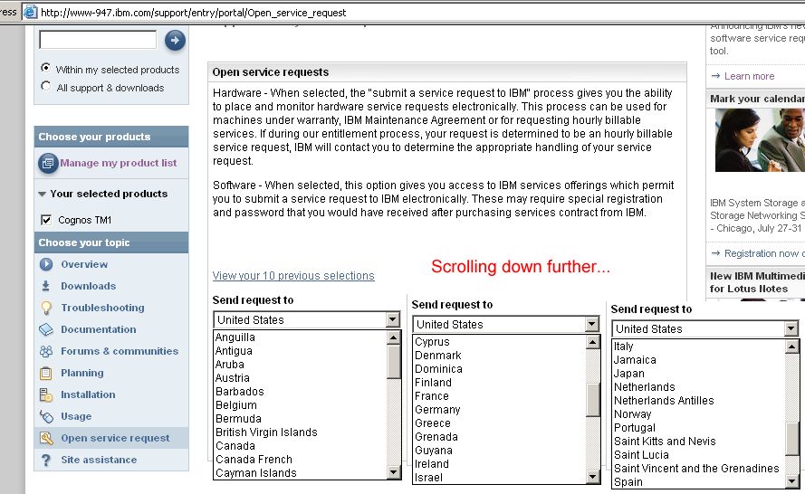

Of course, there is still one thing that throws me. You have to specify which country to send the support request to. So lemmie see now...
Antigua... Aruba... Austria... Barbados... heeeey, waaait a minute...
Hmm. So you can submit requests to an office in St Lucia, but the 19th largest economy in the world doesn't rate one.
Thaaaaat's nice.
So... make a lot of revenue out of the Netherlands Antilles do you, Big Blue?
I'm assuming that the request ended up going to the US (though I found myself in the "Enter A Request" page via a different link, so I don't know for sure); if so the fact that I titled it "TM1 Websheets Do Not Honour Line Breaks in cells" may freak them out a bit.

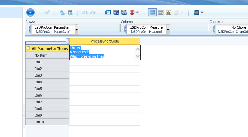

Here's what I've found; I can enter the value just fine with the line breaks using [Alt]+[Enter], and when I am in edit mode it will appear with those line breaks like so:
(What I cannot do, annoyingly, is get that naffing Measures dimension to show ANY element other than the first one no matter where I place it in the view, even if I choose a different element by selecting it and clicking on the stupidly designed green window frame icon which somebody decided was more intuitively obvious for "keep" than a green checkmark, but that's a bug for a different time.)

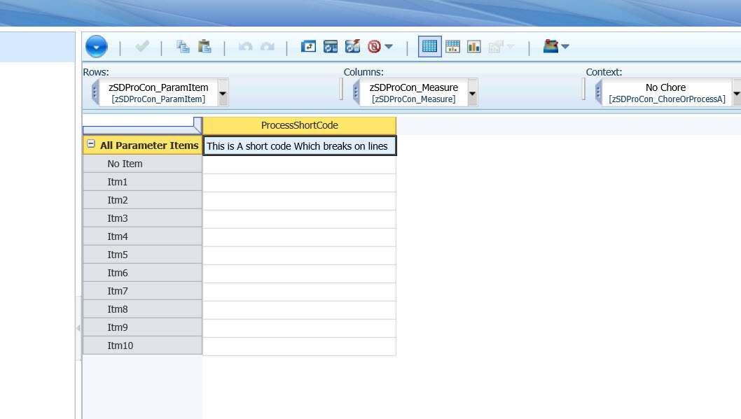

However for display purposes the entry is an exercise in futility since, you guessed it:
So it may be IBM's idea of "fixed", but I'm none too sure that it's thine or mine.
