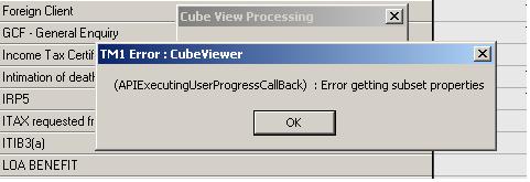

Hi All
Can anyone explain this error message to me?
Check Attachment
Thanx
Error Message
Error Message
- error message.JPG (18.01 KiB) Viewed 3226 times

Re: Error Message
Had you been logged in but inactive for a while? I've seen that before when the server has a timeout parameter set. I've had a cube view open, been to a meeting and came back after the timeout period. As soon as i tried to do anything in the view, i got that kind of error.

Re: Error Message
Sorry for bumping an old post.
I get this message if I have rebuilt a dimension whilst the cube viewer is open.
