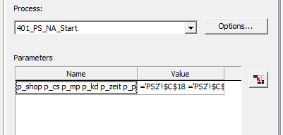

In an active form I'm using an action button with process call. The process has several parameters. When saving and reopening the active form, all parameters are merged in one "Name" field and values also. Is this a known issue?

I have seen that before, but I had been switching the worksheet with the Action Button back and forth between different versions of TM1, so put it down to that. I think I just recreated the button and it sorted itself out.

Any solution? I am using TM1 10.2 & Excel 2013 32 bit on 64bit OS.
Still the action button parameters are merging up.
