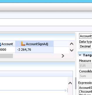

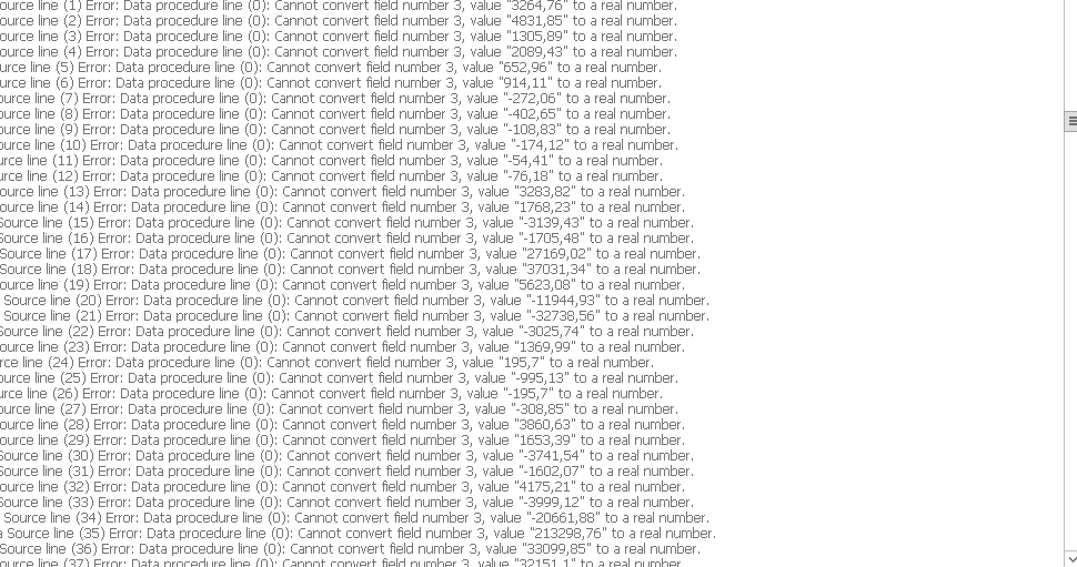

However, as soon as I defined DatasourceASCIIThousandSeparator=''; and DatasourceASCIIDecimalSeparator=','; on the prolog tab, I get an error saying "Cannot convert value ... to a real number" (Cannot_convert.PNG) and no values are imported. In the mapping tab data preview the data looks right (decimal.PNG) and the data type is set to decimal. Moreover, I cannot import the data values straight from the source file (field number 3 in the error log is the original value) and I have to use a calculated column that switches the sign of the data while needed (this cannot apparently be done by weights, since the data needs to be seen with a different sign also on the leaf level) To sum it up, in Performance Modeler I've only managed to import too big values or no values at all.
