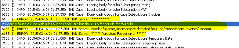

Looking through the logs I have found a feeder error for a cube actually. never seen this error before and it says "Feeder file error/inconsistency detected for Subs Revenue cube reason: Previously found a cube with rules but no feeder file but there is a feeder file for this cube" - see screenshot attached
Now the chore that runs at 3 am is supposed to delete all feeder files so when this model is starting up there should be no feeder files in the data folder anyway so I'm not sure why it would get this error unless there was a feeder file in the data directory?

I'm still confused. You're saying you both need the feeder files and your deliberately deleting them. Why are you deleting them? If persistent feeders are enabled, they will be saved during shutdown anyway. The error message would seem to indicate that it's your messing around with feeder files that's causing your problems.danielpeeroo wrote: Yes we need the feeder files as we need the persistent feeders for the model start up, if we ever need to restart the model during business hours.

Apologies as it didnt seem to attach first time but its there this time defo

I believe this is caused by PI16796.
In some releases, TM1 only handles when ALL feeder files are present or when they are ALL missing. If some cubes have feeder and some don't the server startup can have issues. I believe this is fixed in 10.2 RP2 FP1.
As a workaround, make sure if you're deleting feeder files you delete all of them. This is probably best achieved AFTER the server has shutdown so you know TM1 won't be creating any more .feeder files.
