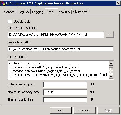

I am a real tomcat novice and much more comfortable with IIS but with the help of this technote here are what I think is the full configuration settings for tomcat and the java vm.
Here are the settings for tomcat. Max memory has been set to 65 GB ...
This is the full list of the advanced java options as plain text:
-Dfile.encoding=UTF-8
-Dcatalina.base=D:\APPS\cognos\tm1_64\tomcat
-Dcatalina.home=D:\APPS\cognos\tm1_64\tomcat
-Djava.endorsed.dirs=D:\APPS\cognos\tm1_64\tomcat\common\endorsed
-Djava.io.tmpdir=D:\APPS\cognos\tm1_64\tomcat\temp
-Dorg.apache.tomcat.util.buf.UDecoder.ALLOW_ENCODED_SLASH=true
-XX:MaxNewSize=384m
-XX:NewSize=192m
-XX:MaxPermSize=128m
-Xmn32768m
-Dcom.sun.management.jmxremote.port=7999
-Dcom.sun.management.jmxremote.authenticate=false
-Dcom.sun.management.jmxremote.ssl=true
-Dcom.sun.management.jmxremote.password=false
-Djmx.remote.x.server.connection.timeout=1000
-Xgcpolicy:gencon

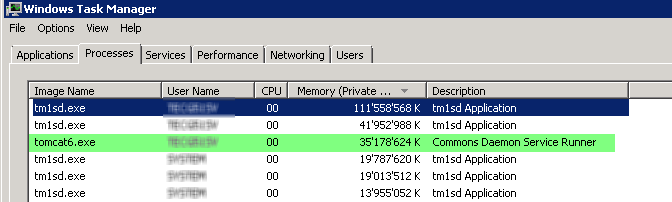

As you can see the tomcat server is consuming a tad over 35 GB!
The max memory setting and the rest of the tomcat config was actually done by IBM SG. The best explanation I can get as to why it is so high is "there should be at least a 50% buffer between actual usage and the maximum memory allocation setting to avoid slowdown in performance, web freezes and the need to frequently restart tomcat." But as to WHY tomcat is needing so much memory no one has yet provided an explanation. This is a dev environment with 20 developers and testers using it. IMO there's no way tomcat should be needing that much memory and I'm concerned about what's going to happen in production when we have 200-300 users hammering away during the planning cycle.
