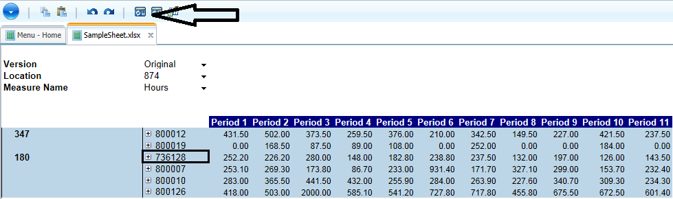

The sheet opens with all accounts collapsed

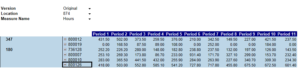

Then One of accounts is expanded so the user can adjust the value for a Leaf cell
Screen2 - Account 736128 Expanded.png (25.15 KiB) Viewed 13353 times

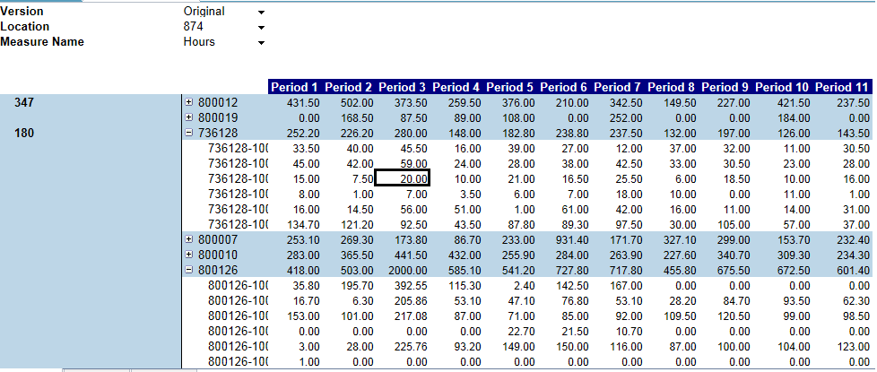

The user adjust the value for one of the Cells, from 20 to 2000, the cell shows in green since the websheet is not calculated yet
Cell Value adjusted from 20 to 2000, websheet is not calculated so the cell is in green
Screen3 - Adjusted a Cell Value from 20 to 2000.png (32.11 KiB) Viewed 13355 times

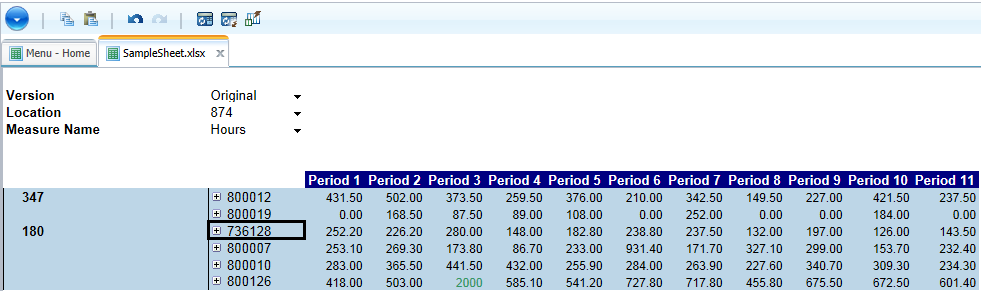

So after the Leaf Cell value is adjusted, the Parent account is collapsed again ( without recalculating / refreshing the websheet ). As you can see, the value 2000 ( green cell ), remains in the same position, which corresponds now to a different Level 1 account
Screen4 - Account Collapsed after changing the Cell Value.png (24.3 KiB) Viewed 13353 times

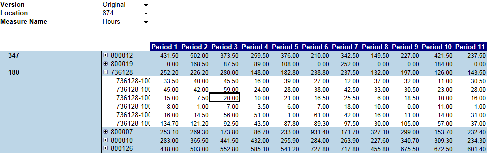

After clicking on Recalc button, the value of 2000 gets saved to the Level 1 account ( because that cell is a consolidated cell, it actually spreads it down to all leafs )
Screen5 - After clicking Recalc button on toolbar.png (29.71 KiB) Viewed 13353 times
So when I expand again, I see that the cell that was adjusted ( from 20 to 2000 ), does not have the adjusted value, but the adjustment is saved under the Level 1 account!!!!!
Screen6 - Expand again to see what happened to Adjusted Cell.png (34.47 KiB) Viewed 13353 times
Isn't this stupid??
