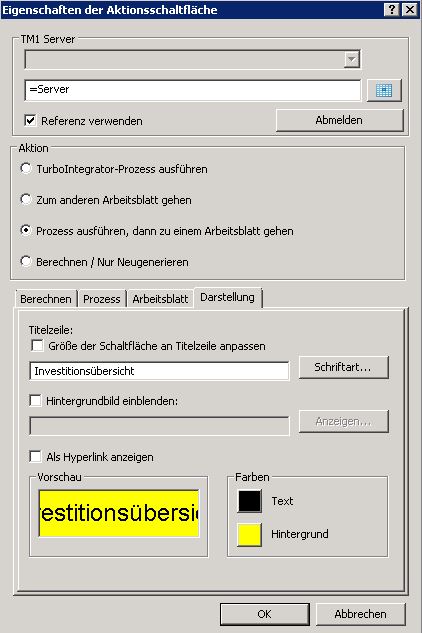

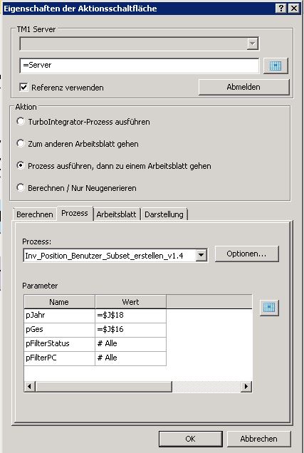

Re: TM1WEB File not found
Sounds to me like your action button is not configured properly. Can you post screenshots of each tab in the action button setup?
Willi
Posts: 151
Joined: Mon Oct 07, 2013 11:51 am
Version: 9.5.2
Post by Willi »
Of course. But I forgot to mention that it works if the user works via Excel.
Willi
Posts: 151
Version: 9.5.2
Post by Willi »
Tab4. I was only allowed to attach 3 files.
