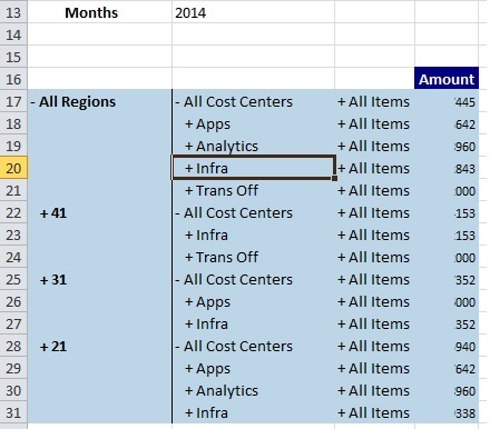

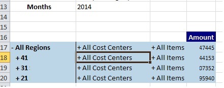

I am creating an Active Form report in TM1 Perspective version 10.2.2.
My Active Form reports looks like below.
My issue is specific to drilldown/Expand feature. When I expand All Cost Center just for 41 element, then it behaves weird. It expands All Cost Center for all the elements of Region dimension.
So It looks like below.
Ideally Cost Center hierarchy should have been expanded for Element 41. but in my case Cost Center hierarchy is expanding for all the elements of Region Dimension.
Same is the case with ALL ITEMS hierarchy. if I expand just for a specific combination then it expands for all.

Re: Active Form Drill Down
This might be "weird" (to you) but it is "expected behaviour" to anyone who has worked with TM1 for a while. Unfortunately all native TM1 interfaces such as the cube viewer and active forms do not support asymmetric slices/views.
Basically you need to live with this limitation. Probably many people would support a request for enhancement to provide this feature though ...
