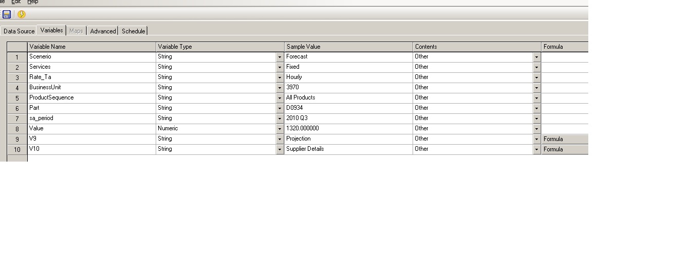

Thanks Wim, Sorry for the delayed response, got caught up with other issues. Finally this is test scenario I have tried for copying the data from 7 dimensional source cube data to 9 dimensional test target cube. If it comes off correctly, I could finally implement the same with 14 dimensional target cube.
Since most of the dimensions defined in the cube as picklist exist in the model, I am using these existing dimensions, I have wrote the below code and process is copying the values fine when I define individual elements of the two new dimension using CellPutN statements in Data tab. The data is getting copied over correctly.
But when I try to substitute element name with dimension name in order to copy the data for all the elements of these two new dimensions it renders an error “Data Procedure line 33, Invalid key name and element name”.
As I have defined them (two new dimensions) as new variable for example V9=’Projection’; and V10=’Supplier Details’;
But taking it off and also didn’t work.
I have also checked the dimension order of both the cube, it is in same order.
Also, Created Zero level element subsets for the both dimensions and assigned it to the target view but to no avail.
I know the error means the dimension doesn’t consist the element in question doesn’t exist in the Projection Dimension.
I can't destroy and create these dimensions in metadata as they are used in other cubes.Moreso due to the fact pick list values being rendered upon the title dimension element selection and sometime it could be empty.
Apparently by defining this new dimension as variable I am not able to call it in the process and ending up with “Invalid key name and element name” Key
Three to four dimensions have quite a few elements and writing hundreds of CellGetS is practically not feasible.
Appreciate if gurus could please help me to resolve the issue, would be very much thankful for your help. Thanks in advance.

- Variables tab
- Variables Tab.jpg (92.44 KiB) Viewed 19212 times

Hi Carl,I have tried your code at work ,the process ran for 17 Min for about 240321 records successfully still the data didn't get copied over,I checked the source cube and the data was available for selection title dimensions and combination of picklist elements.
I need to do data mapping also in order to make sure same data available for combination of elements selection as is in source cube ,Any help on this please!
I am wondering what would be the performance hit if I copy the data finally to 14 dimensional cube.Now the code in my data tab looks likes this,I have also tried little variant of this (Thanks to Tomok).Appreciate your help.Thanks.
with little bit variation:

****Begin: Generated Statements***
V9='Projection';
V10='Supplier Details';

Hi TM1 experts, Rather than starting a new thread ,I thought to continue with this one as issue is pertaining to this requirement.
Now I have other issue at hand and couldn't able to get it around.
I have facing strange issue, all dimensions have numeric elements but when I run the process
I am getting an error,
"20.20.20","Regional","Hours","PITS_CHFMI_TEWP","002","R78085","Expansion","SLT",Data Source line (23) Error: Meta Data procedure line (0): Cannot convert field number 8, value "SLT" to a real number
Here,SLT is of numeric datatype,I have deleted the destination cube and created again with different dimensional ordering ,even tried StringToNumber etc but no success.
I have done assciioutput on the original cube strangely same error popped up when i ran the process.
Any thoughts please.Thanks a lot.

Hi Abdul,BariAbdul wrote:Cannot convert field number 8, value "SLT" to a real number
The error states that it cannot convert the value "SLT" to a number, which is logical as "SLT" is not a number...
I'm a bit puzzled by your remark underneath the error message.
Michel

Thanks Michel,I am puzzled too! Since all the dimensions in this cube has numeric datatype elements ,still "Can't convert to real number " error I am unable to understand.

Hi Abdul,BariAbdul wrote:Thanks Michel,I am puzzled too! Since all the dimensions in this cube has numeric datatype elements ,still "Can't convert to real number " error I am unable to understand.
The error message is about your data source, not your cube. You receive a value "SLT" in field (variable) 8, which you declared as numeric, but there is no way "SLT" can be converted to a number.
Michel
- Posts: 1833
Re: Copy between cubes
Just to add a little more to Michel's point; I see a lot of new users go down this route. Just because an element is "n" type that does not mean that the element name is a number.
"SLT" is a numeric element but it is obviously actually text; as are all element names (even if the name is "100" just to add a little confusion) therefore you need to select string type on your datasource. The only things likely to be "numeric" type in a datasource are the numeric values you intend to put into a cube cell via a CellPutN... there are a few exceptions to this but that is the general concept.
