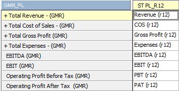

I have 2 different dims 1-Account and 2-Statistic Measure.
The idea is to have a single attribute (in the account dimension) which in this case is called "ST PL_R12" so when a user selects a specific account in a websheet the report will return the corresponding statistic measure.
Account Dim example as follows:

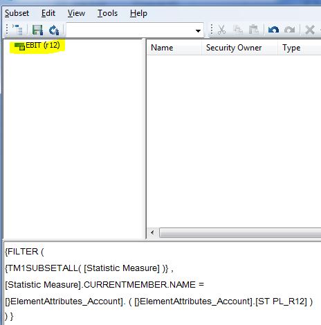

My current MDX syntax in the Statistic Measure dim is:
However as it can be seen above, it only returns a single element.
I'm expecting something more like below

Re: MDX Filter based on a different dimension attr
This has come up before if you search. Doing a filter in this way in MDX to return a subset by referencing member properties of a different dimension only works if the other dimension is a title element, otherwise there is no context. The foreign dimension that is being referenced must have a static value for the purposes of the query. It doesn't work if both dimensions are on rows.
