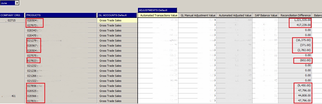

I'm facing a problem regarding the filtering of some elements in a view and although I was able to check some possibilities to solve this I'm haven't been able to close this.
I have a view (see picture in attach) and I want to replicate the following behavior:
- The cube view just presents the elements in GL accounts, products and company org only when the Adjustment Reconciliation difference is not zero.
In the example in the attach, the elements for the 3 dimensions should be filtered to the ones identified with the square.
I'm trying to use MDX and filter elements based on the reconciliation within the cube but I continue to get no values in the view when refreshing it.
Thank you in advance,
Jorge Viegas
Jorge Viegas
- Picture.jpg (137.88 KiB) Viewed 10695 times

the ideia is to select Time in a dimension and get product, company org and gl accounts elements filtered based on the information on adjustments.reconciliation differences

I also think it should be like that but when doing the MDX should I do this for the 3 dimensions (gl accounts, company org and products) or do it only on the one on the right of the "cascade" (in this case the gl account).
I ask this because when I try to filter the elements on the cube I get "No values" and in some cases I should get elements.

I had already read the document before openning the post but I was trying to do this
FILTER(
{TM1FILTERBYLEVEL( {TM1SUBSETALL( [Products] )}, 0)},
[Sales Adjustments].([ADJUSTMENTS].[measure])<>0
However I was getting a "No value" information when placing the dimensions in cascade on row.
I have other cubes with mdx filters working perfectly but this one with the cascade and having more dimensions is getting on my nerves
Thanks for the help

Actually I'm trying to solve this today since I'm still clueless regarding the behavior I'm getting. I read again MDX primer in the part you've pointed out in the previous posts and tried to replicate this in the cube but with no success.
Every time I try to filter the one of the dimensions with a tuple to get the elements with the column value not null I get the "no value" information. And following what you've said and I was also doing I'm testing this still in architect to try to solve this.
Krs,
Jorge
Sorry on the delay answering but I had to be some days off.
