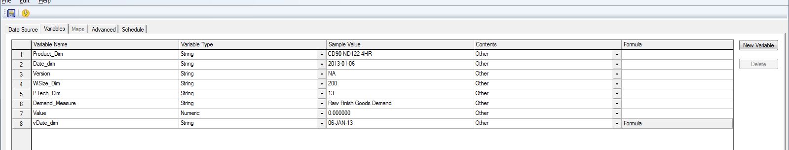

Looks like you are trying to copy from one measure to another within the same cube ABC,Screenshot of your variable tab would be helpful.Thanks

Re: TI CellgetN and CellPUTN
@BariAbdul:
Yes, I am trying to copy from one measure to another within the same cube ABC based on Dates.
Please find the attached variables screenshot and below Prolog Code for reference:

@BariAbdul:
