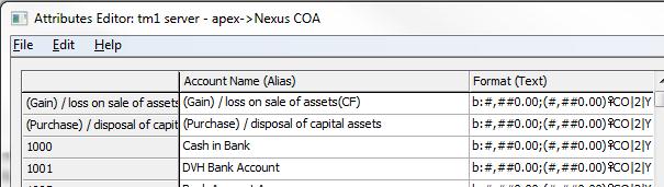

Cell B12 has the formula, =DBRA("tm1 server - apex:Nexus COA",$A12,"Account Name"), where $A12 is '1000. It returns the attribute, Cash in Bank, which is the Account Name (Alias) for element 1000.
Here's a screenshot of the attributes editor for Nexus COA.
It looks like the formula is correct as it's returning the desired value. So I am confused about the Circular References: B12 message at the bottom of the first screenshot.

2limit2 wrote:It looks like the formula is correct as it's returning the desired value. So I am confused about the Circular References: B12 message at the bottom of the first screenshot.
The screenshots are useful and demonstrate that there is no obvious error in your formulas. However, did you try restarting your Excel session or doing the full workbook recalculation, as suggested?
